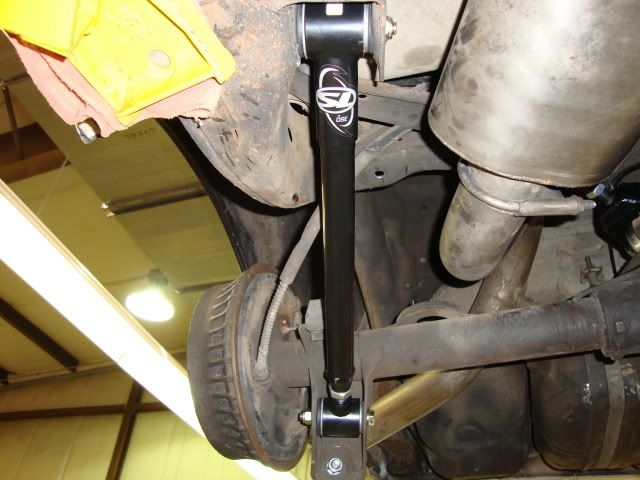

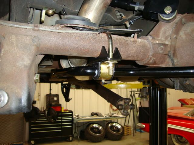

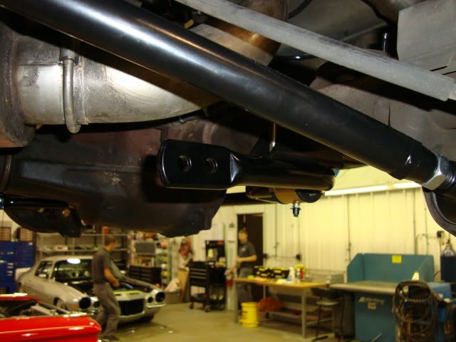

REAR:

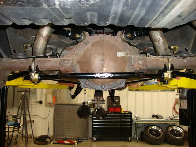

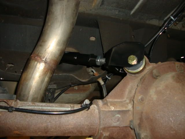

* DSE Upper & Lower Adjustable control arms
* DSE Rear 1 1/8" Chassis mounted Tubular Sway Bar
* DSE 2" Drop Springs
* DSE Shocks
* DSE Drive shaft loop

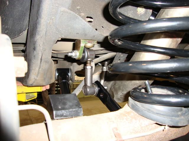

Here we will install the front DSE sway bar.
In these pictures you see the DSE relocation bracket for the sway bar. This bracket is there to move the bar forward a bit from the stock location. (Not to worry it actually has MORE clrearance now over the stock one!) Must be due to the design of the DSE sway bar it's self.
Here is a few pictures of the DSE patented sway bar "Swivel Links"tm installed. These were designed to elliminate "Bind" and allow for the front sway bar to articulate better with the front suspension to keep all 4 tires planted to the ground. In these pictures you can also see the shocks installed.
Here is the Sway bar mounted..

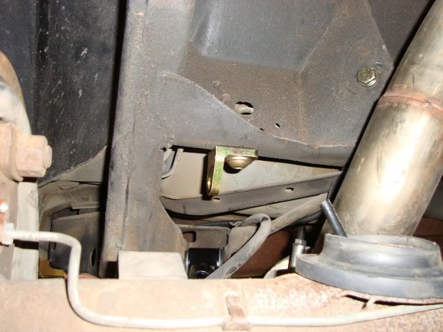

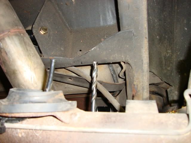

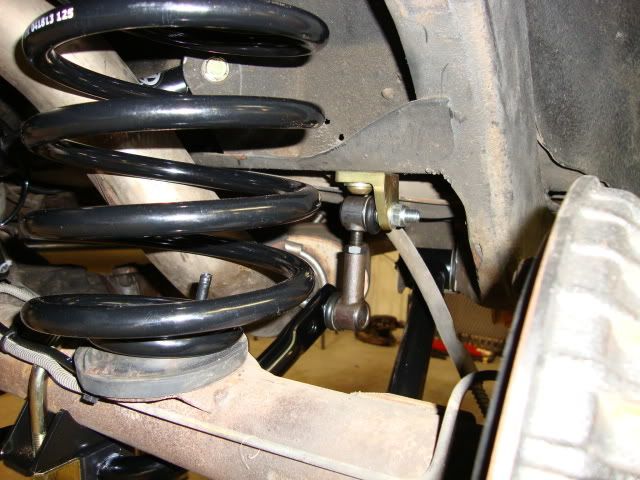

Here is a few pictures of the DSE front Frame Braces installed. There is still Plenty of room for front mount I/C pipes!
Note: These Braces come with the purchase of the front sway bar!
The DSE "Drive Shaft Loop" installed..

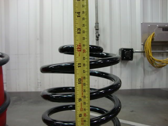

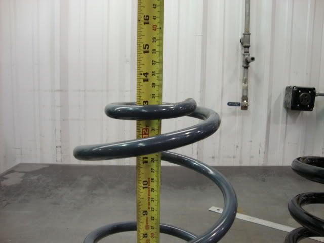

Here I did a few measurements with the Front old springs compared to the new DSE springs.
Here are the results:
"Stock 24 yr old spring Height" = 14-1/8" Tall
DSE Front 2" drop spring Height = 12-1/16" Tall
NOTE: Although the DSE springs are considerably lower prior to going in the car. The ride height only dropped 7/8" inch!
OLD "Front" Ride Height = 25.5" (measuring from ground to fender lip).
New DSE "Front" Ride Height = 24 5/8" (Measuring from the exact same place as we did for the Old ride height)..
SW.
