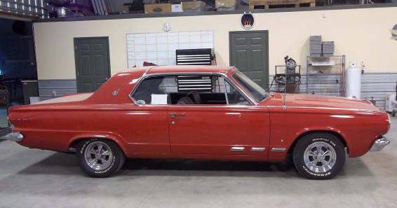

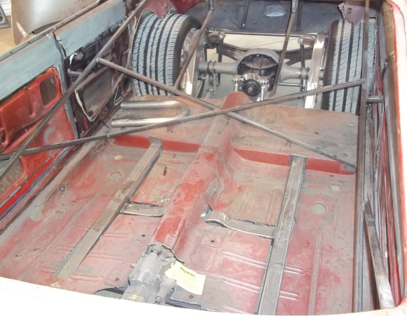

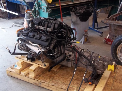

1965 Dodge Dart GT it was a 273 with a 4 speed. Its getting a supercharged 5.7 punched out to a 392 with a tremec 6 speed. The front suspension is from Magnum Force and the rear suspension is a custom torque arm with a watts link with ride tech coil overs. Wayne and Pam McGriff at M and M will be taking care of the interior.

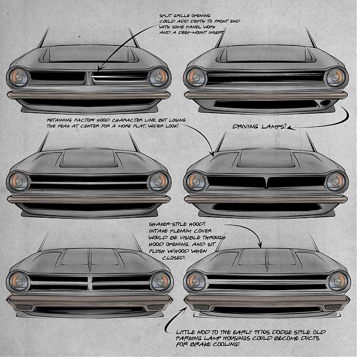

Hey Will… Post up a rendering???

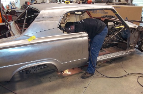

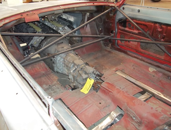

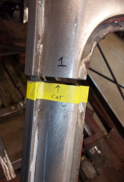

Here are a couple of more pics and I will be posting up some more soon.

Why did you cut it in half?
