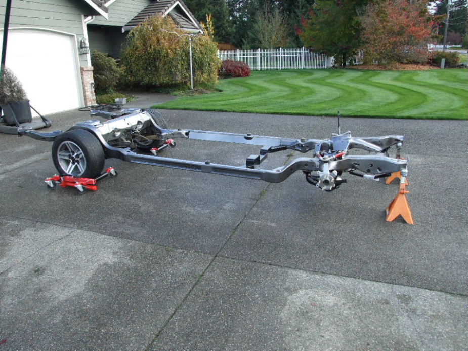

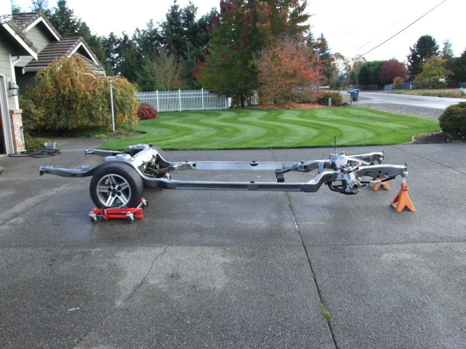

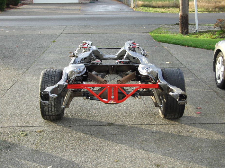

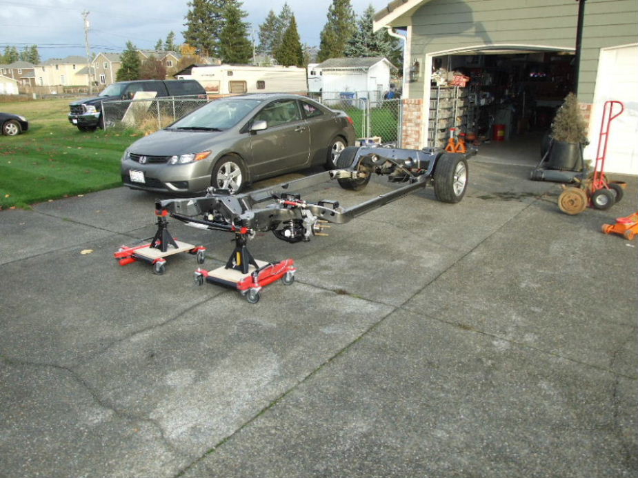

We have finally made some progress on the project. We got the frame boxed and welded all the seams. The SCandC front suspension package with the ATS Spindles looks great. The Fays2 Watts link was an easy installation. A friend dropped off a Ford 9" this week that will replace the original GM 10 bolt. The frame has been powder coated in a silver vein hammertone that my son picked out. I was sceptical when he chose the color, however, I feel the finished product looks great. Time to order some brakes and keep things going.

Pretty frame. Nice lawn too!

Notch the rear frame now while the bodys off, it will be a joke.
I notched mmy 84 Regal and put 315s on 17x11s back there! Its worth the extra work. Visit "MAXCHEVY.com for excellent instructions!

Any more pics of the watts set-up? Particularly where it bolts to the frame in relation to where the OD of the tire is (assuming a ~26" tall tire).

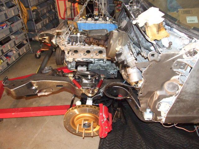

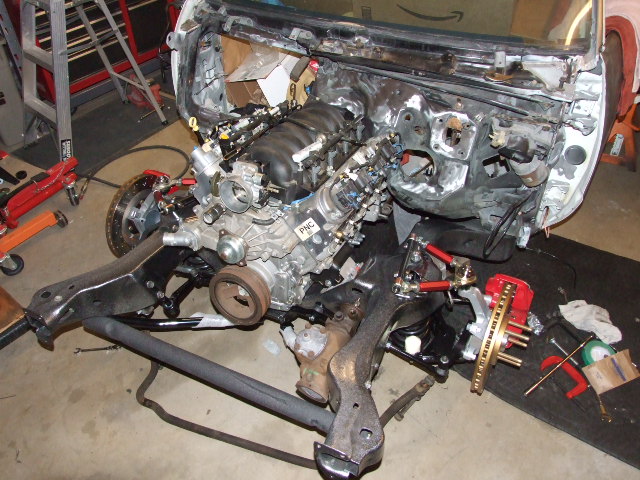

I picked up an F-body LS-1. I purchased the motor plates that are used for most applications and found they did not work. The studs that mount the motor mount "cup" had to be moved down a half inch on each side. Other than that it dropped in nicely. I have the TH-350 mounted behind it right now. Still considering my transmission options, maybe a gear vendors behind the 350, late model 4 speed od or a manual transmission. The oil pan has plenty of room away from the front cross member, however, I am concerned it might be hanging too low.
