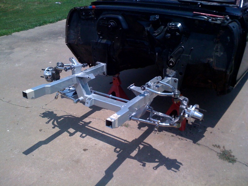

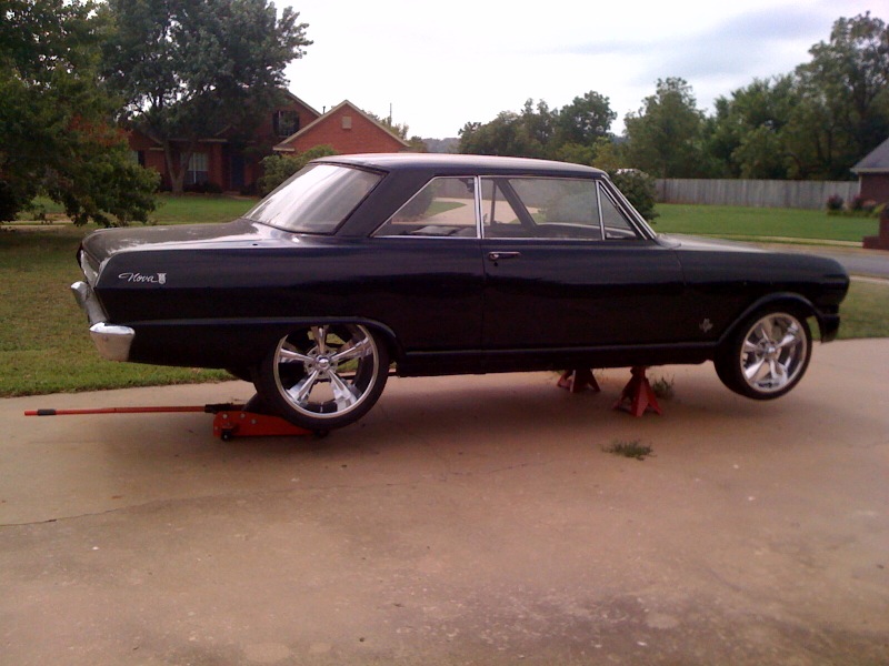

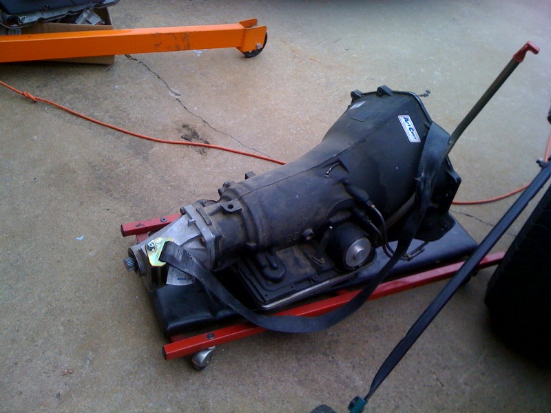

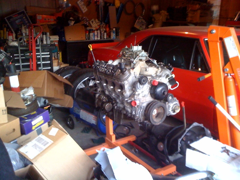

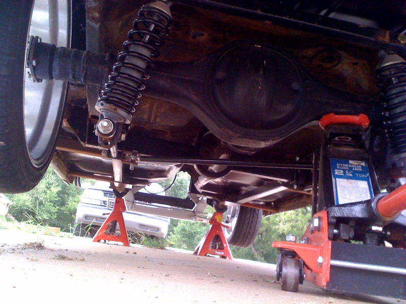

Just finished a 67 Camaro Build, so I started on my 65 Chevy II. I do not care for the front end look on the 65 so will clone a 63. Car has a TCI 4 bar rear with 9" Ford, TCI coil over front sub, 275/35/20 rear tires on 20x10 Streeters and 18x7 with 215/40/18 tires. I have a 2000 LS1 with Edelbrock Carb Conversion running a 750dp Holley, But have decided to swap back to the Fuel Injection. Has an Art Carr 700R Manual valve body Trans, With a Billet 3500 Converter. I have the car all mocked up, and getting ready to pull apart to paint. Still a long way to go but getting closer.

Memory > me but I think that front anti-sway bar will interfere with the LSx pan. You'll need their new front mounted bar, that just happens to be bigger.
