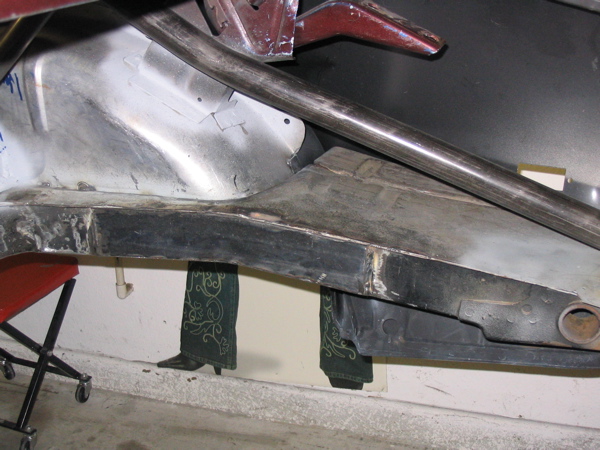

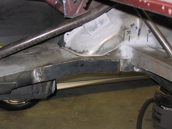

Default notching stock rails
i have to admit,i questioned the strength of the frame rails after doing dse kit (per their instructions) so i added 1/8 on back side of rail and attached braces with plate from roll cage at the area in concern.hope i,ll be okay.making 900hp at flywheel.well be making hard launches at the drag strip,(1.38-1.40 60 foot).will have my answer soon 1-2 months
