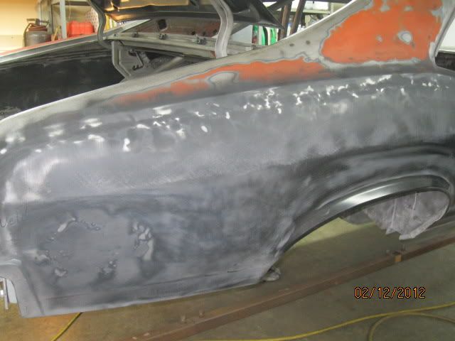

Hi everyone
I'm in the being stage of doing the body work on what 72 Nova and need to know if everybody tries to get ever high and low spot out before they add filler or do you get it close and start filling.On the body,to save on epoxy paint I've been working the metal before I epoxy then I'll mist with cheap spray paint then block sand work metal again and check metal again.When finished I'm planning on sanding all the cheap paint off and when spraying with SPI epoxy.Both quarters were replaced with half quarters and I flanged the car and I mig welded the quarters.The door was pretty meshed up and took alot of work to get it looking this good it had alot of filler on when I first sanded it down.Please all body guys chime in.

The better the metal is the better the final product will be no way around it. On the door I would re-skin it unless you really like the way it fits or just want to practice on your metal skills...

When I purchased the car I had no idea the door was like this,but worse.The door fits very good and no rust at all.

Spend as much time as you can possibly afford to get your metal smooth to cut down on the amount of filler as J2 mentioned. I'd stay away from using cheap paint as guide coat, because it will be clogging your paper. When you think you're done with primer, shoot one wet coat of over reduced primer with a little basecoat color . You can also mix different color primer for last coat to chase high and low spots.Remember to epoxy before doing any filler work or you will end up redoing it all few years later

I agree with getting the metal as straight as possibly but when I keep tapping seems as if I create more issue like the spots gets flexibly then I have to fix that and believe me I'm no body man.I have issues when to stretch and when to shrink those soft spots.Can some please tell me how to determine what to do when it comes to that and how you do it (what tools etc.)

Look into buying shrinking disk,it's cheap and can do wonders on high spots or stretched metal

I would do some research on shrinking. We always use a stud welder with no stud in it. Iv'e never used a shrinking disc but that looks like the way to go to learn how it works, not do more damage than good and get some work done.

You can do a lot more damage with stud gun than shrinking disc,at least in my opinion,since you have to push on the gun for the tip to collapse and get the outer housing to contact the metal.
