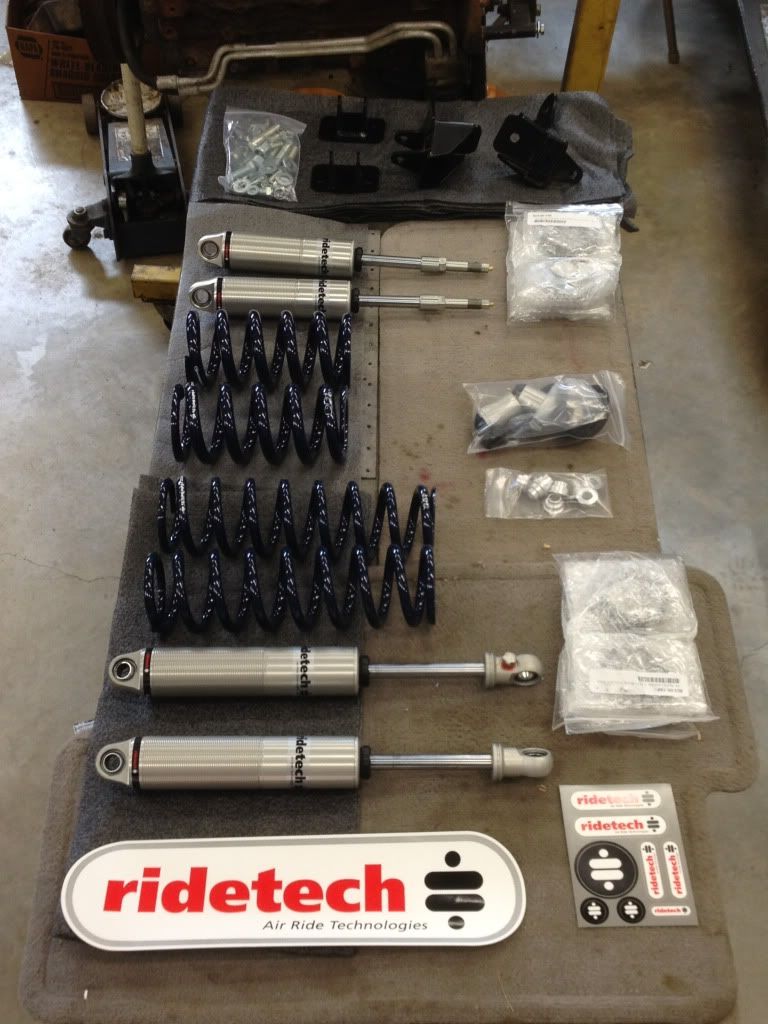

The boxes as they came in.
The boxes all unpacked. This is the front and rear coilover set up's.

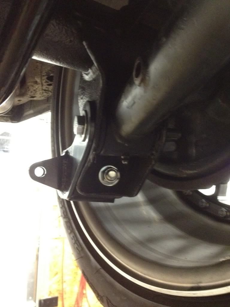

Driver side lower bracket installed
Passenger side lower bracket installed
This is a view of the support bolt that also holds on the lower bracket.

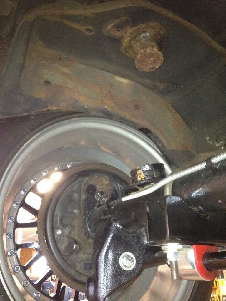

It does look like the lower brackets are close to my wheels. My rear wheels are 18x10.5 and there is about .75 inches between the bracket and tire.

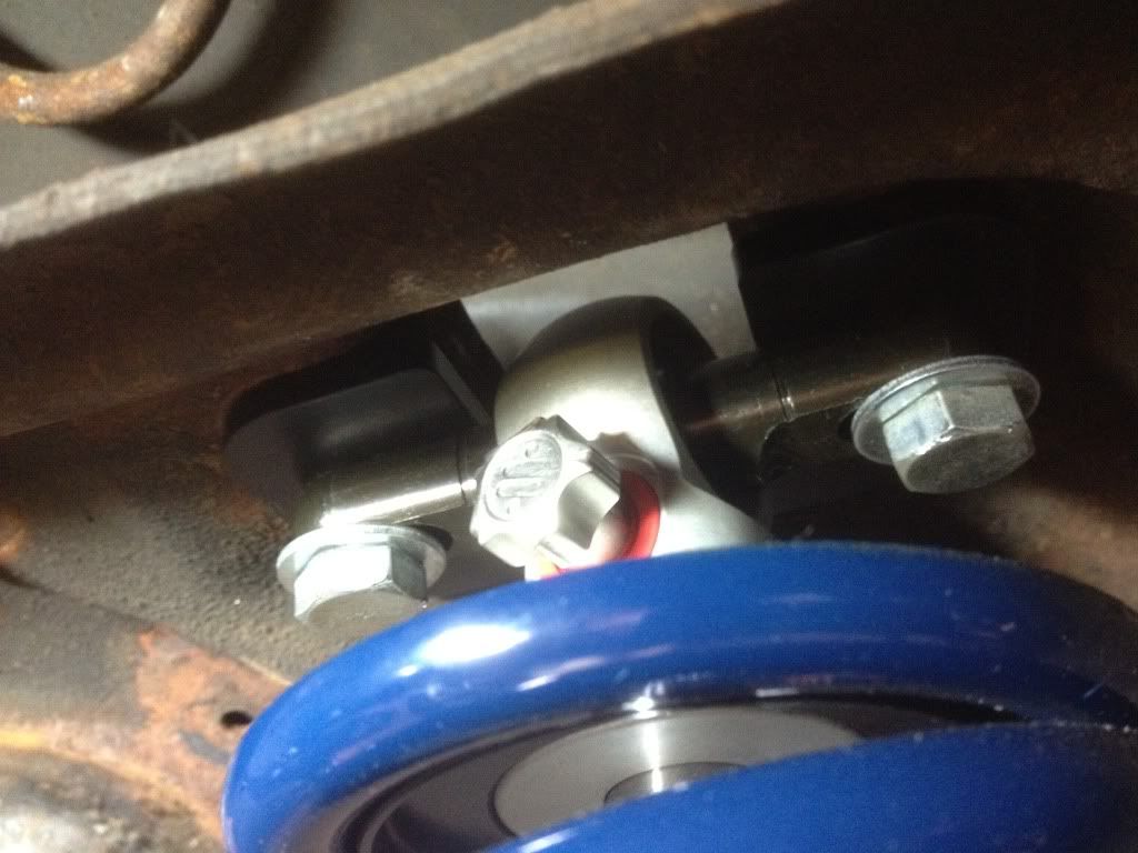

This is a pic of the set up installed with the supplied brackets.
To get my desired ride height I had to turn the bottom spanner all the way down. This was not desireable because if I ever caused the suspension to unload enough the spring could have popped out of the spring cups...and that's a bad thing!
I drove it like this around the block and zip tied the spring to the upper mount so it would not pop out of the spring cup.

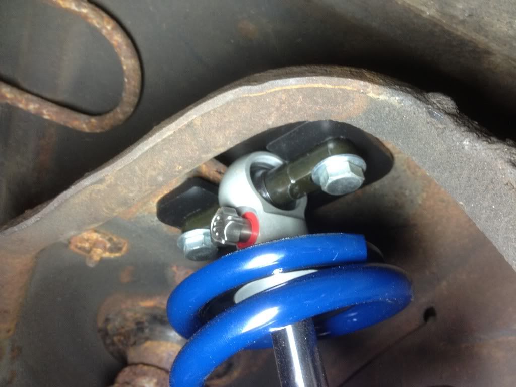

To remedy this situation Darren at Ridetech thought outside of the box and sent me some A body upper coil over mounts. These mounts are actually a t-bar set up and are very similar to a factory G body upper shock mount.
Here is a jig that I came up with to compare the two mounting solutions. The A body set up is on the left and the supplied G body set up in on the right.
Here are the T-bars and the spring clips that keep them in the shock eyelet. They are tricky to install but a small screwdriver took care of them no problem!!

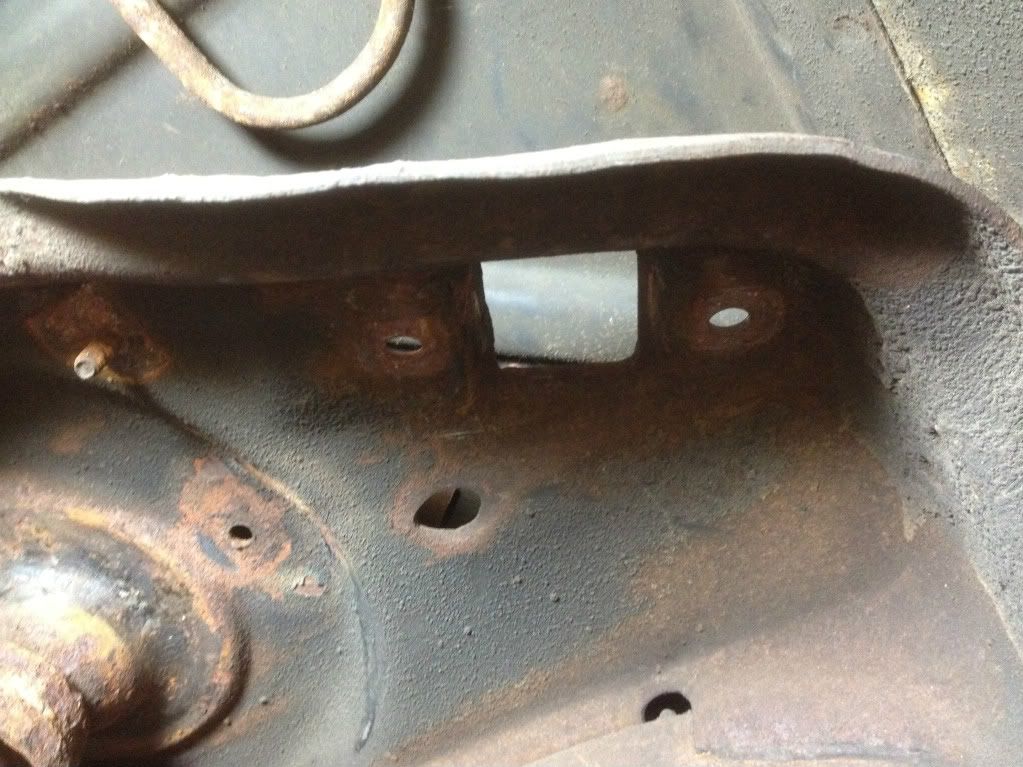

The factory upper shock mounting holes were too small and had to be drilled out to 3/8"
Before
After

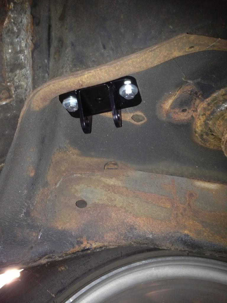

This is with the upper mounts all installed. Follow the directions for the A Body mounts because the stress the fact to be sure to mount the bolts from the bottom up!!!. Ridetech supplied 1.25" long bolts but like the shock bolts I went with a little bit more thread engagement and got 1.5" bolts.

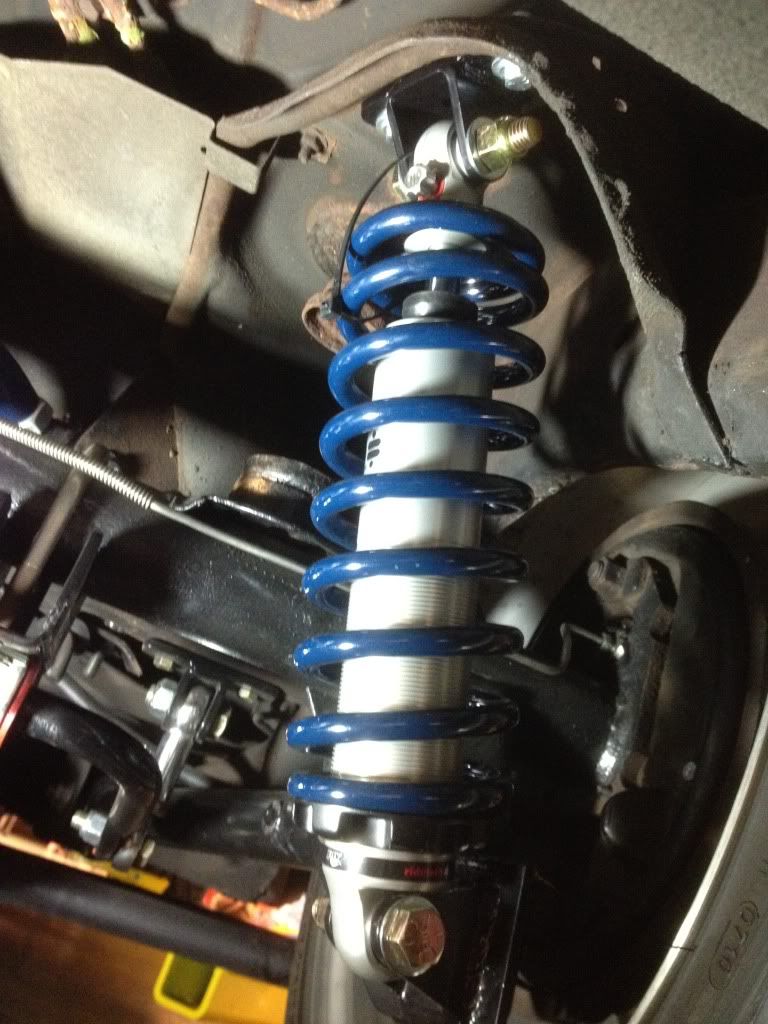

This is how much travel I now have at my desired ride height. For what it is worth the top of my rear fender is 26.75" from the ground and that's with a 295/35/18 tire on a 18x10.5 rim.
Ridetech says that these shocks should be between 13.5-14.5 inches from eye to eye at ride height. That lenght is in the shocks "sweet spot".
Pic of the final product.
Cool view from the rear of the car...those coilovers look good under there!!!
I am very impressed with this coil over kit. The difference in ride quality and handling is night and day!!! The guys at Ridetech really helped me out with the ride height issue and got me to where I wanted to be. I couldn't be happier with this product! The springs and shocks are 100% A+ quality and they are made in America...which just makes it that much better!!!
