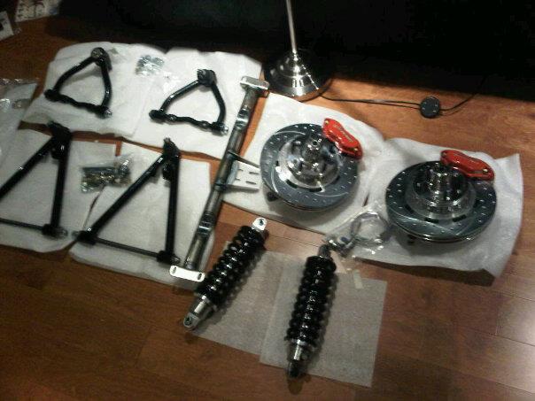

I've started collecting parts and pieces for the car like a complete TCI front clip set-up

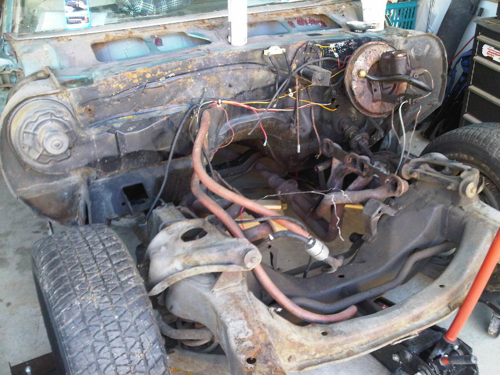

I've started dismantling the car and getting ready to flatten the firewall. The whole reason I came accross this website;
I've stripped down the firewall and get ready start some welding;

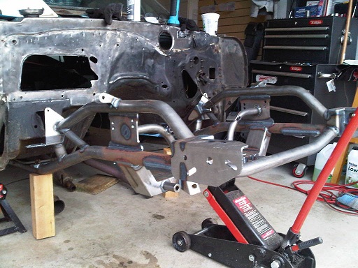

Time to test fit the TCI front clip and make sure it lines up before it goes out for powder coating;[/SIZE]

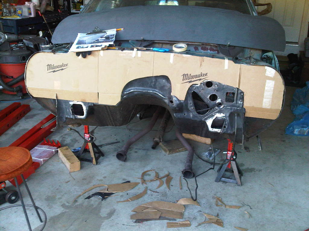

So I continue my quest to flatten the firewall so I picked up some 18 gauge to start making my own template and weld in piece.
After looking at a bunch of other builds on Pro-Tour I took the jig saw to my firewall and swiss cheesed it.
Starting with some cardboard I built a template for the tin so it would match the firewall how I wanted it
Traced out the cardboard template onto the tin
Voilą I have a rough metal firewall layout
A little trimming to get it to fit how I wanted and drilled a couple holes for the fender mount bolts and it is ready to weld in

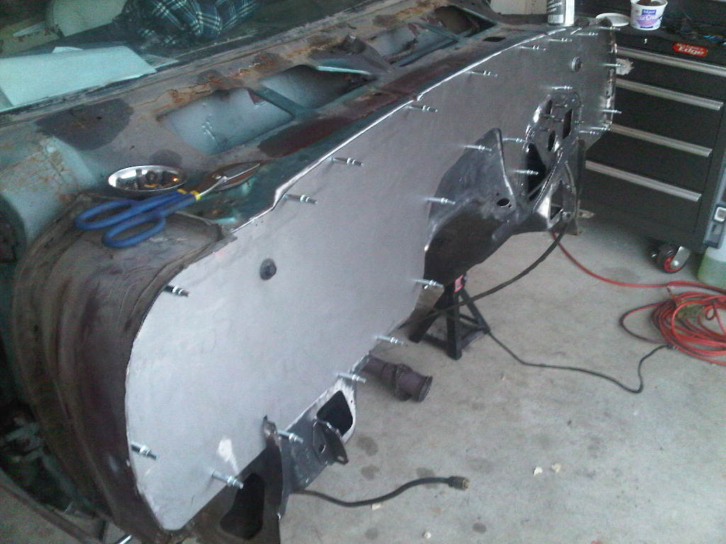

The firewall is ready to be installed and it's time to start welding it in. As I haven't done any welding in a long time I thought it best to take some of the sheet metal cut offs and do some practice welds before I start on the car.
Once I was warmed up I started small stitch welds around the new firewall;

I did some more welding on the firewall. As someone else stated on their build this is great practice for the parts that are more obvious.
Started laying on the mud
Next step is to shoot some primer after a couple more rounds to straighten out the sheetmetal and then one more test fit of the TCI front frame before it goes out for powder coating.
