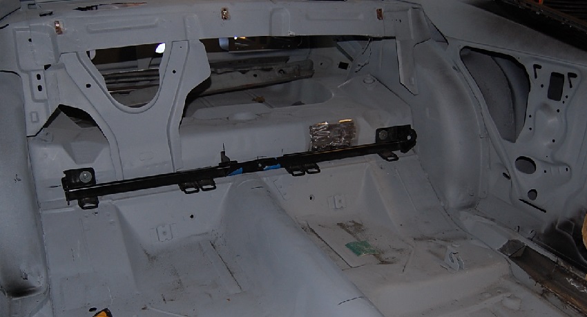

Im making a set for my girlfriends 66 Mustang so I can put the seat in the rear middle. When the Camaro's come back from paint Im going to do the same thing to them. I will also be doing a stress pull on the mustang to give me a piece of mind.
Gotta protect our babies as best as we can.

If you look at the ones in a new car they are not exactly substantial in girth. Some are probably 1/8" solid round stock. The key is how they are attached. On the bottom ones I would try to tie them into the existing seat belt bolt holes. The package tray was never designed to take that kind of load (in an actual accident) so I would get a lot more creative there.
