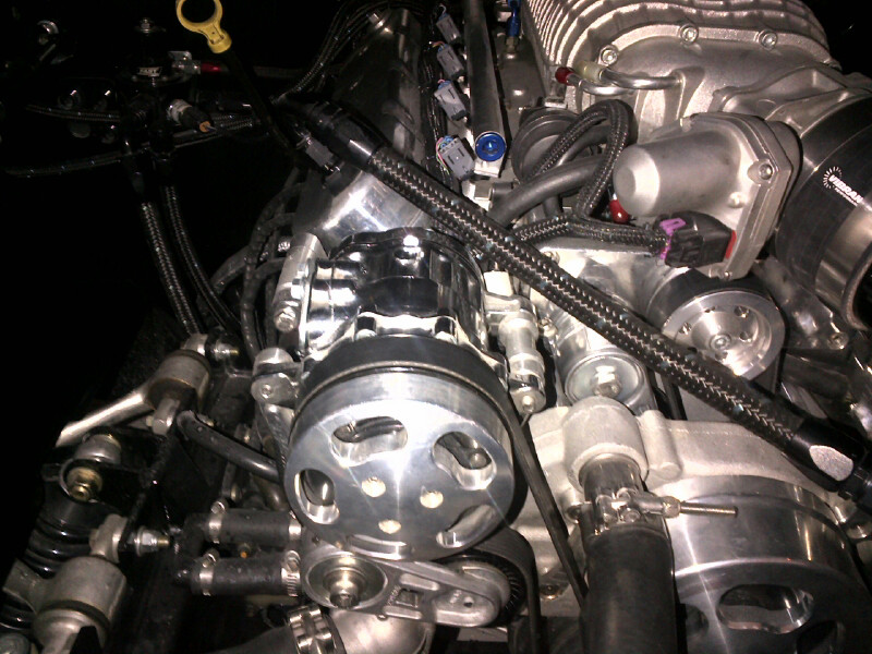

Here are some crappy pictures, I don't know if I should use two cans (one for either side) and do I need a vacuum line? I am told the way the shop installed this setup is not right as the can is down below the motor but then again thats just what I have been told so I don't know if it is right or wrong -- thanks for your help!

Definitely not a good spot for that can. You definitely want it above the motor but not much.....valve cover breather height would be fine. Any room on the fire wall?
That's what I thought, I was thinking of putting the one from the Drivers side on the firewall and making a bracket for the one of the passenger side somewhere in front by the AC unit.
