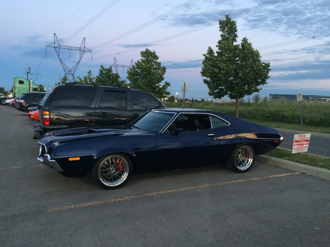

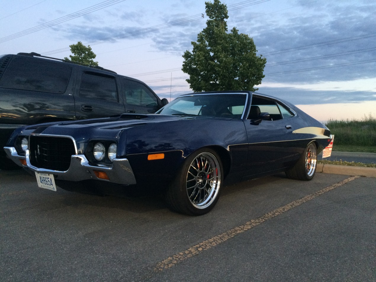

Our 72 Gran Torino just throwing it here, most recent father and son project, 68 camaro in the works as well.Will start a thread on that soon and maybe get more pro pics on the
Torino[ATTACH]Name:  111111111.jpg

That's a good looking car! Please give us more details about the work.

472 ci bbf, rollerized c6 with changed 1-2 ratios, overdrive unit in the near future, 3 20 gears for now. stock front suspension, stock spring height, qa1 adjustable shocks on all corners, saginaw quick ratio box converted
modified front spindle to accept modern mustang slip on hub bearing, no drop. narrowerd rear frame, custom lower adjustable rear control arms, stock tubs with very slight massage, stock length 9" rear end. 19x9 and 19x12" 3 piece forged ssr wheels
255 40 19 front 345 30 19" rear ps2s
14.2/14" srt8 rotors and brembo 4 piston calipers, custom brackets, custom integral parking brake. Ford Kona blue paint, ground up rotiserie resto done right, noise and heat isoletaed with neoprene, jute, dynamate. 2.75" manderel exhaust out the back, '12 mustang gt front power seats with tracks, custom rear bench to match, custom inserts in door panels to match
seat pattern and material, rest of interior stock - restored. Lot of atention to detail went into this resto, not much out there for these Torinos . Will get proper pictures soon

That is a bad ass Torino! I'm guessing one of the few ever modified like that in the world.
Great job.

As far as I kno, yes, the pure vision car and this. There is few guys doing some improvements and mods on the Torino forums, nothing on a major scale tho, believe there is also 5.4 swap done already too.

Love this car. Very nice
My buddy just bought a couple of 72 Rancheros
with the same front end but they will never be this nice

Very Nice looking car!
After 1971 The only Torino I liked was the '72 Sports. Had one many moons ago a 429 4spd

What a beast! Beautiful ride !!

Looks great
