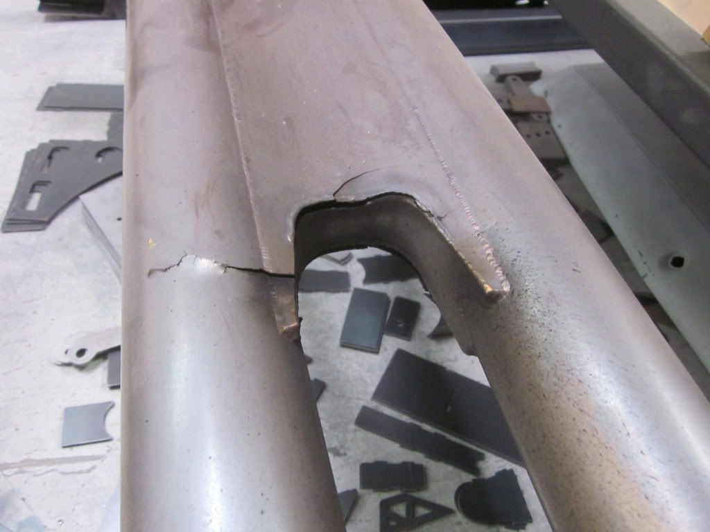

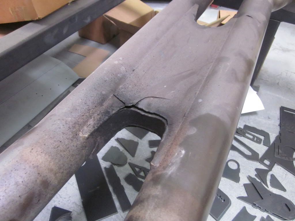

here is what SS exhaust looked like after running it @ RTTC this weekend on Blu Balz... I had to drive the car back from Irvine to LAX to drop off Karl @ the airport then drive to Oxnard.. I was deaf when I got home!
Notice that it did not break @ the welds.. I think my exhaust system is a little to stiff.. need some more rubber exhaust hangers..

Interesting cross-over, tough to factor all the stress points with expansion/contraction and I'll assume torque twist.
Looks like some of the beads could have caused stress-risers?
Some broke behind the bead, material became brittle after welding?

Looks like stress fracture. starts from no where.
Drill a hole in each end, weld it, then lap some new .065" stainless sheet over it.
Just a thought.
