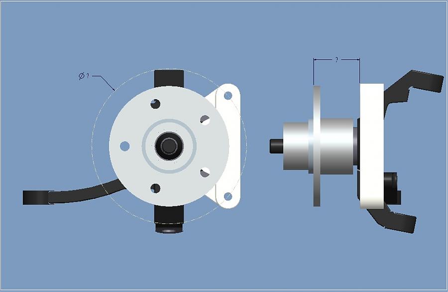

Hi. I will be installing 2013 Shelby Brembo brakes on my 67 Cougar, but need a couple of dimensions. Does anyone have the dimensions in the picture below for the s197 generation mustang? I need the bolt circle dimension (front view) and the offset from the hub (right view). Thanks in advanced.
Robert

Bump. Hopefully someone might have these dimensions. Trying not to purchase a spindle/hub assembly.

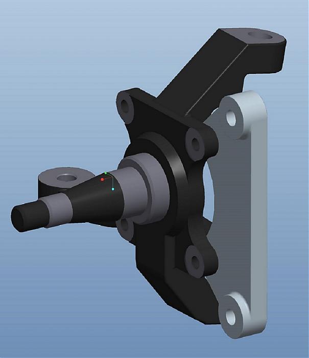

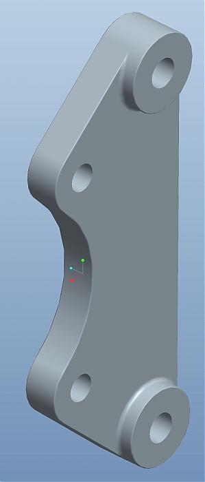

Just a little update of the bracket I came up with.

Have you tried contacting Brembo to see if they already have a bracket for your setup?
I've done several Baer/Shelby setups on 67 Mustangs and your bracket looks awfully familiar.... really just going to be a few .001 here and there depending on the caliper mounting. Let me know if you need any measurements against parts I have sitting here.
I have not contacted brembo, but when I had looked at there website, they did not list any disc brake kits for fords older than 1994. I also didn't think they would offer a bracket to bolt the Shelby 6 pot calipers to the wilwood pro spindle I am using since there are so many different variations/setups.
As for the measurements, do you have the ones I asked in the initial post? I plan on purchasing a s197 mustang spindle to confirm the dimensions I got when I mocked the brake setup at home.

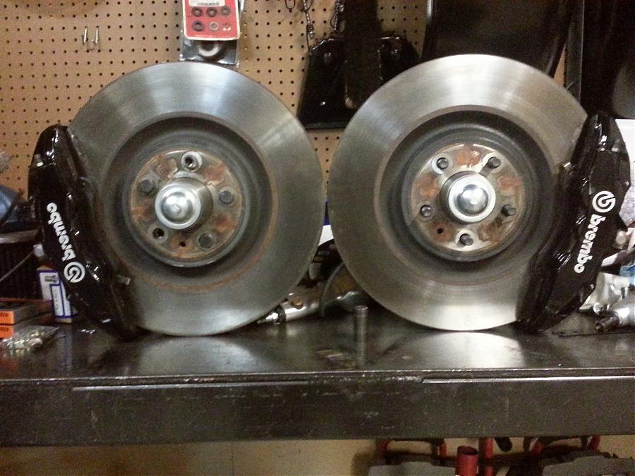

For anyone still interested. Now to the next problem, WHEELS!
