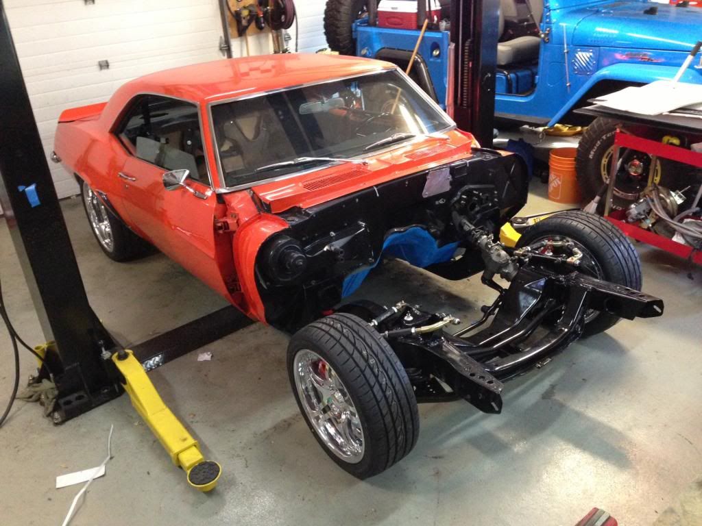

As a novice builder my ONLY complaint are the instructions, I wish they had much more detailed, step by step pictures of an actual install. There are a couple of pics but so much is left out and if your not a professional mechanic the terminology can get a little confusing. That said I got it done, and it took me about 2 days to complete, and here are some pics ...
Got the rear end 2 feet off the ground (using the lift in my garage to install)
Installed shocks and panhard bar
installed trailing arms
Got the torque arm positioned and ready
Lowered the car into position and bolted everything together
Absolutely top quality stuff
I was looking for a suspension with the adjustability to give me the perfect stance that I wanted, and I got it ... Could even go lower if you wanted, these are Rushforth 19's (thanks Jason !!)
So to the novice builders out there that are contemplating a rear suspension, do not be intimidated with this setup because it requires some welding. Take the rear end to a shop and have it done properly, and get a buddy to help weld in the X member, other than that this system is soooo easy to install, and the results are amazing

Man, sorry to hear it was all such a mess in the first place but glad to hear it all worked out. Thanks for the compliments. As one of the newer folks in the Speedtech family one of the reasons I packed up and moved 2500 miles to work here was how genuine everybody is. Speedtech's goal really is to see to it that you, the end customers, have a positive experience with both customer service and the products themselves. Looks like it's working that way for you. Glad Jegs came through and we could be there to back 'em up.
As far as the installation, glad it went well for ya. Just wait till you drive it, the best is yet to come. And remember, once you get it rolling if you need help with dialing anything in just give Roger or our tech dept. a call.
On the instructions, thanks for the feedback. We agree, they're a bit outdated and have been discussing for a few weeks the need to get them up to date. I've started going back and am updating each set of instructions with better (and more) photos and clarifying/ simplifying some text as well. As they get wrapped up they will start circulating with the parts.

Thanks Ben, everyone makes mistakes and again it was handled brilliantly by both parties.
As for the instructions and I can tell you that pictures are worth a 1000 words, and I hate to say it but Chassisworks has done a great job with their instructions (take note ... And oh ya, I cannot wait to try this car in the spring, it kills me to have to go into the next six months of winter waiting for spring to experience not just the suspension, but the new 496BBC that Chris Straub has assisted me in putting together, and Jason Rushforth is doing up some designs for stripes to lay on the new color choice ... French racing blue
