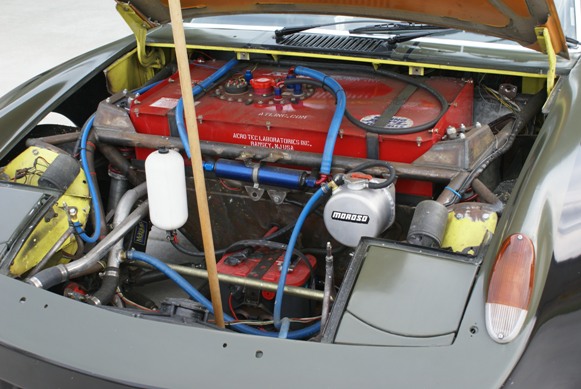

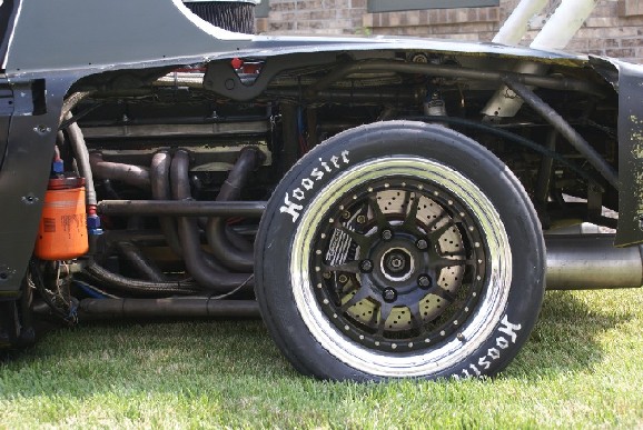

just found this section in the forums today and figured I should do my part It's rough but it's a road race car - I recently added a Mendeola sequential shift transaxle to it over the winter, so next racing season should be a blast - first available track day of the year is a month away assuming the weather isn't bad.

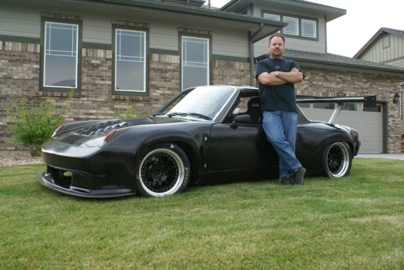

the one with me standing next to it gives an idea how short the car is - I am 5'10".

even kneeling I am taller than the car Forgot to mention it is totally street legal (loud as Hell with the 3.5" diameter sprint car headers and mufflers slipped over them but otherwise ) as you can see the wipers, signals, etc in this photo. Headlights function as well, tho' I recently removed the motors and you have to put them up by hand to save some weight, but technically I have headlights and can drive in the dark.

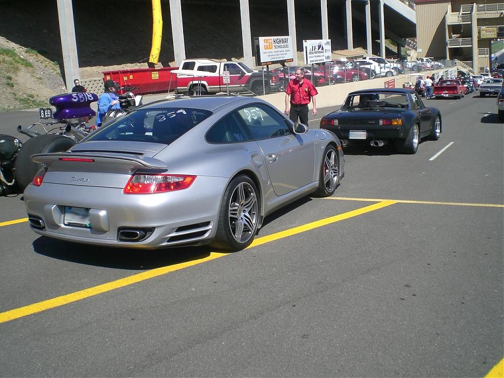

Thanks! You'll like this photo given your 996TT... went to the drag strip here in Denver just for fun with a friend racing his car and this guy got behind me. The AWD made a huge difference, we both ran 114mph but he did it at 11.97 sec and I did a 12.78 burning rubber most of the way Fun to have back to back Porsches run the same mph tho'!
Very nice! I actually have my front diff and driveshaft removed so I am RWD.
