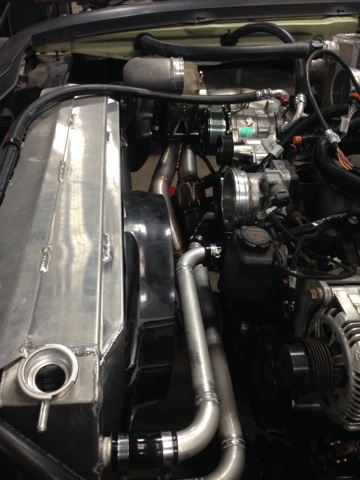

Put in Vintage Air a/c and some nice brackets were fabbed up to make it look right. A/C bracket is from Holley. That picture shows the CG&J radiator in the back, then the intercooler heat exchanger and finally the a/c condensor.

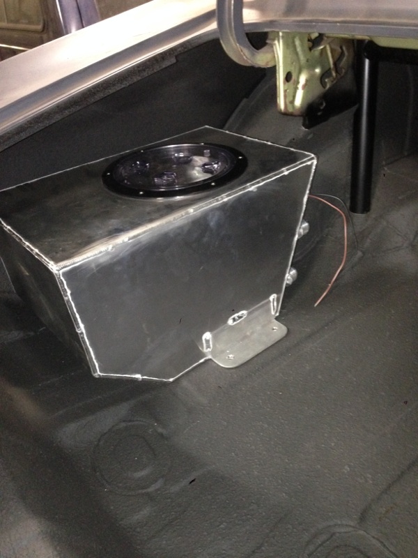

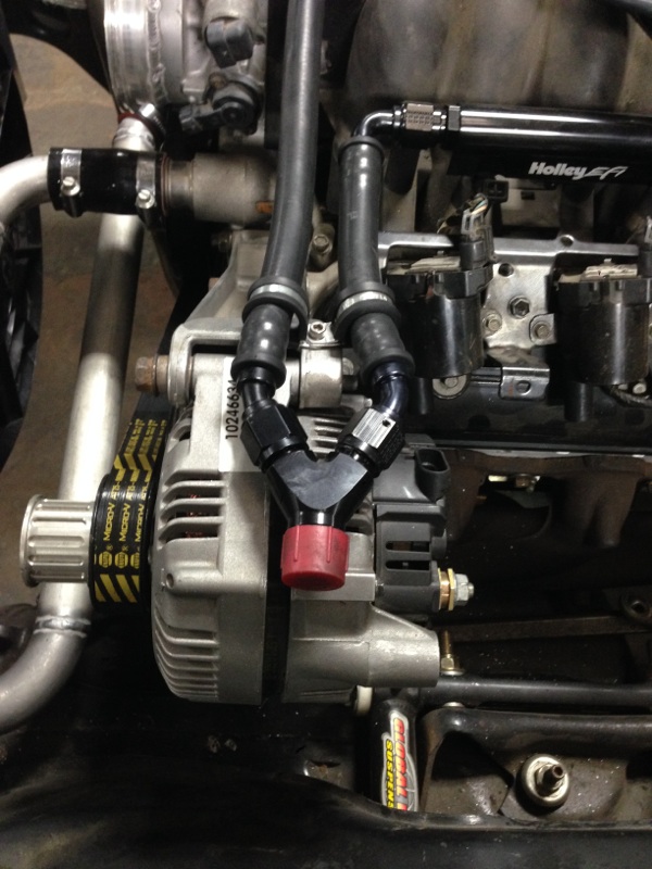

Chris welded up the intercooler water tank with clear lid opening for my Chiseled Performance 1500hp A/W intercooler and a Rule2000 pump inside the tank. The system including the water in the lines and unit itself should hold around 10 gallons I'm guessing. He also added a cogged drive for the GZ Motorsports vacuum pump driven from the alternator. Thankfully the Chevelle has a very generously sized engine bay and can swallow all these parts up with ease.

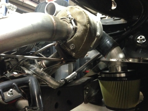

A few more random pics of the build. Note the bellow for the air filter that goes from 6" down to 4" inlet to the turbo.....and Ford Taurus 4000cfm e-fan. They really suck.
