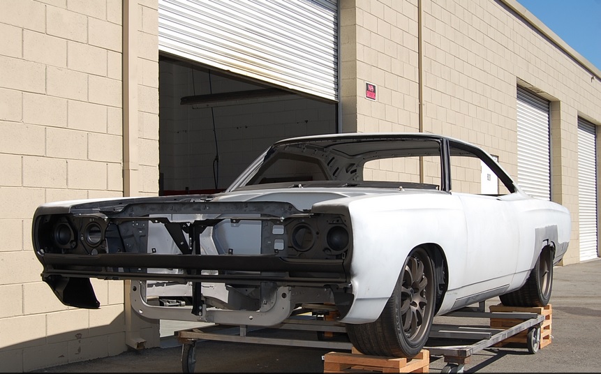

Here is the 325's on a 12" wheel.
just the right amount of buldge and height.

Looks good Vince, Thanks for the pictures
