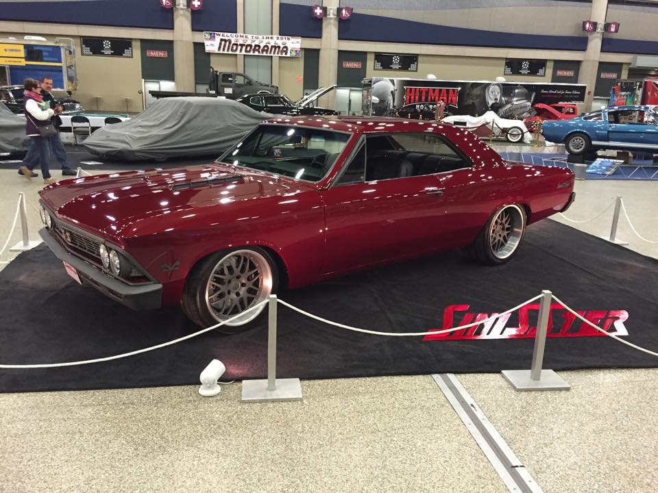

First post, but I've been lurking for a while. Been busy finishing my 1966 Chevelle build dubbed SiniSSter, while planning and running the Buffalo Motorama indoor car show. SiniSSter made it's debut on March 27-29, 2015.
SiniSSter started out as a clean 3 owner 136 Malibu that lived it's entire life in the Northest. Surprisingly it was a rust free, original sheet metal car.

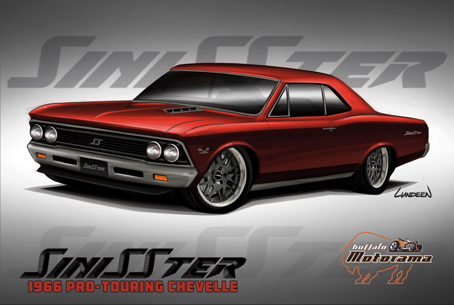

The Chevelle was built by myself, and some great friends. In a 1-2 car garage for the past 1.5 years. It started with a rendering and then progressed from there. More progress and detailed pics coming.

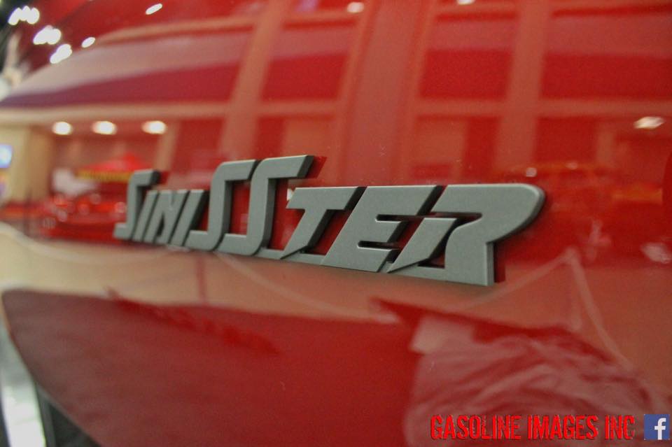

Where did you get the custom Sinister badge made?

The SiniSSter logo was designed by a friend that does graphic design. We worked with Myles Tool and Die (www.mylestool.com) in Niagara Falls, NY with Mark Farina to CNC the emblems and then as all the chrome and stainless on the car, were ceramic coated by Spikeclaw (www.spikeclaw.us) in Tonawanda, NY.

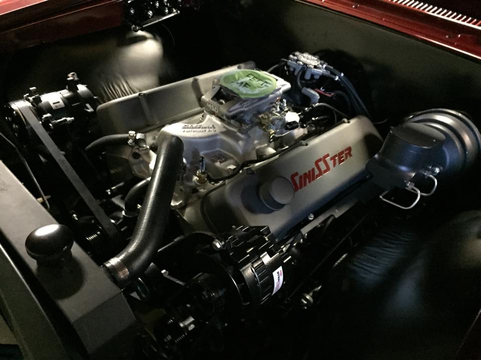

I neglected to show the powerplant. I was going to go LS swap with this build, but decided to go after the heritage of the car, yet modernizing it. So a big block it is.
Mike Janis Racing (www.mikejanisracing.com) built 396 with Msd Atomic EFI and ignition, and Edelbrock and Comp Cams components. Also a custom configuration built for the serpentine pulley setup since many companies don't make a kit for big block Chevy, short water pump, and AC.
The valve covers were CNC engraved by Hot Rod Swap Shop in Ohio.
http://www.hotrodswapshop.com/
