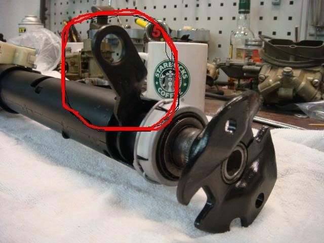

As title says , what is the funtion and reason of this lever in steering colum?
Column is stock , tilt , floorshifter model from ricks 1 gen. I would prefer to cut it off for cleaner look.

im probably wrong but i think its to make sure you put the car in gear before you remove the key, i had it removed on my car when i modded it.

LowBuxs, i would like to do that but i am affraid of steering columns and prefer not to touch it any more than neccesery. But its okay to cut lever off and weld it on that position wich allows keys to be removed?

Realy you can cut it and not weld it and use it as a pseudo theft deterant. When you park the car turn the column by hand to a "no start" position..

I know this is an old post, but I'm replacing my steering column and have been looking for an adapter for the 1"DD end of the shaft to mate to my stock power steering box on my 69 Firebird. The other question we had was what this lever was for and how the new column would work as it doesn't have this? I'm guessing now, it just won't matter if the car is in gear before you can remove the key?

If that lever moves, the steering wheel locks. You don't want that happening while driving!

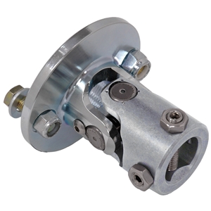

It sounds like you're looking for one of these. http://www.cachassisworks.com/c-1049...s-flanged.aspx
