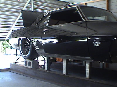

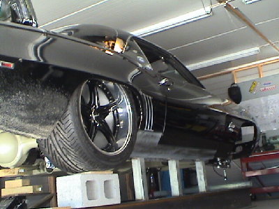

hey man yea i jiged my 69 heres a shot how i did it the car is level with the beams in the pic i tacked the sills to the uprights give me a holler if you need more info

nutsy yea iagree with the lead his would be heaps easyer to work on mine is like that because i removed the entire floor and the car would have flexed too much
