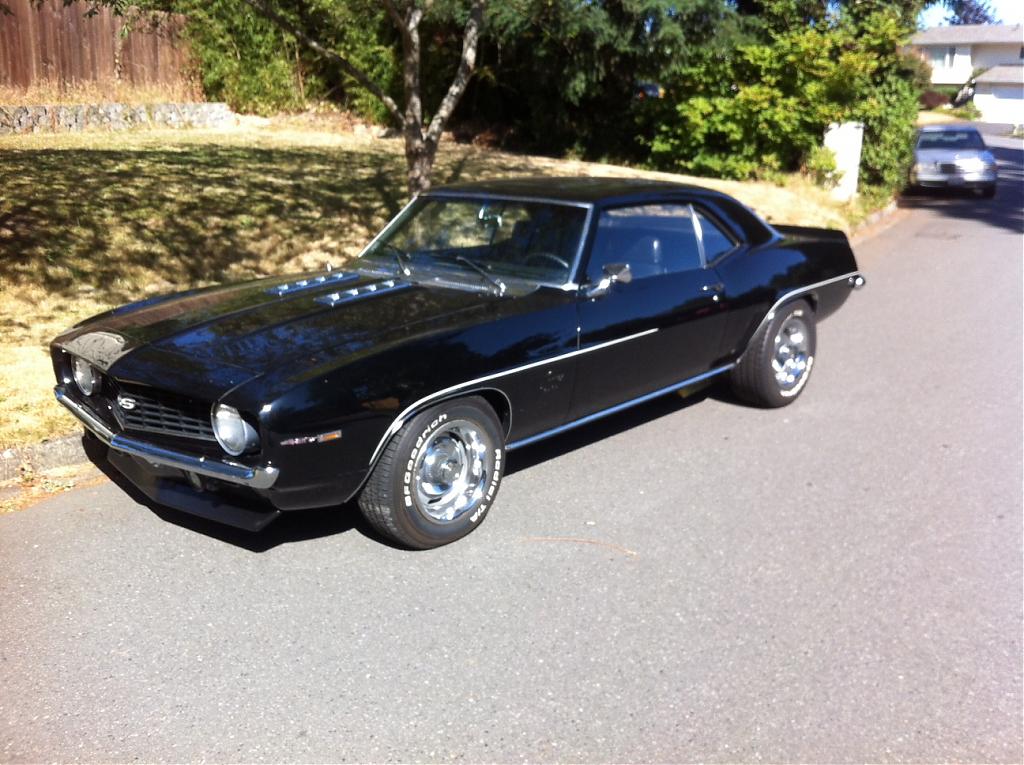

Here's what I started with.. crappy cell phone pic... I'll take a good photo of how it currently sits, and what goodies I've managed to scrounge together tomorrow.

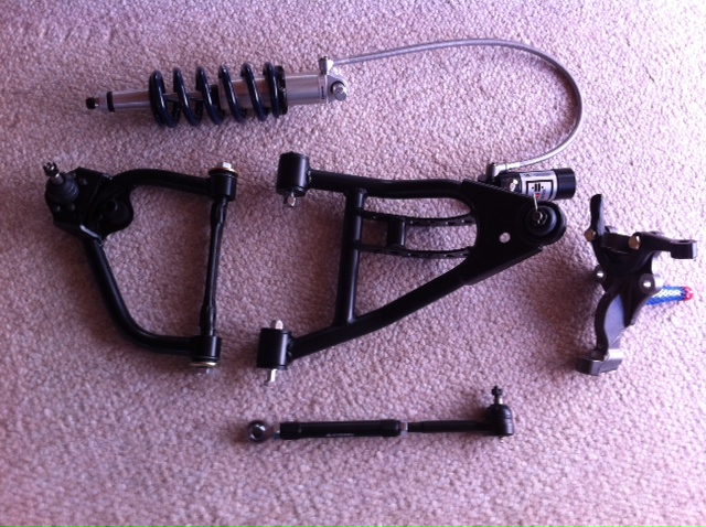

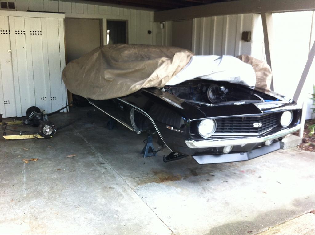

Here's how the car looks now, and what's going in the front end. The subframe mounting points for the lower control arm were a bit pinched, so that was fun to get in, but the passenger side is done, at least.
Question:
Anybody using the Ride Tech triples? Where are you mounting the reservoirs if you don't have a full cage? Just looking for a few ideas.
