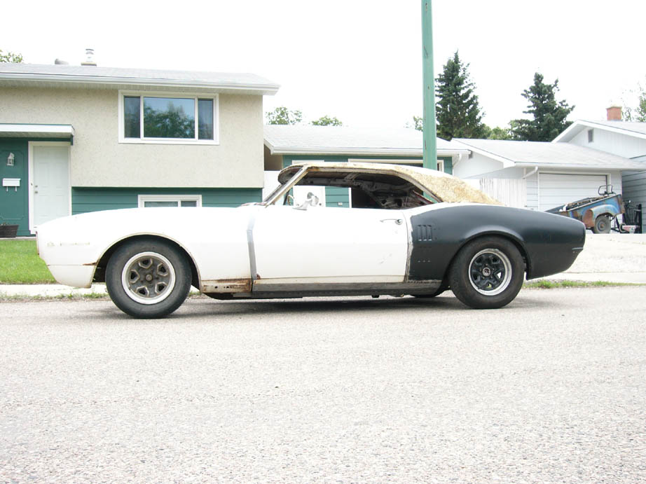

just getting it ready to move....has a homemade 4-link in the back, with a whole new rear subframe...home made mini-tub (4"), aldan eagle coils.....ordered a martz chassis front subframe, with aldans, wilwoods, sway bar, and power rack.
rear quarters need finishing, need to finish the trunk floor, then do the rest of the floor. need to make room for the subframe connectors and exhaust (either single 4, or 4.5" ).
Its getting a BT LSX, with goals of 800 DDhp, might try and hit 1k on a dyno once or twice, but we'll see...thats atleast a year away yet. I have about 3 months (weekends only) into it so far.....lemme know what u think.
oh.... front is gonna be about 1" lower yet, and its gonna be on 18's fr, 19's rr.

Looks like a good starting point. Gotta love those 'birds. Coll project. Just one question: why single exhaust? That will kill your ground clearance.
