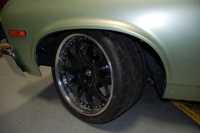

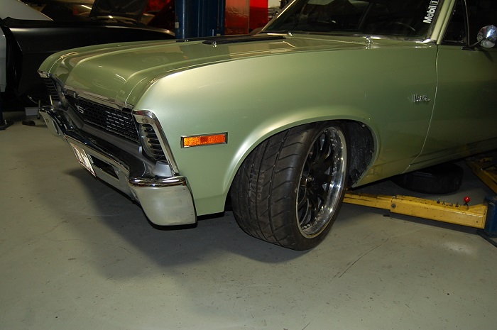

18x10 with 5.75" BS with 275, off the 48 Hour Camaro on my Nova at RTTH's, just to show everyone that it fits and works.
[IMG][/IMG]
[IMG][/IMG]
Here is 18x9.5 with 5.75" BS with 1/4" spacer(so 5.5"BS) with a 275.

Old 04-13-2015, 04:41 PM
IndyNova's Avatar
IndyNova IndyNova is offline
Join Date: Sep 2009
Location: Avon, In
Posts: 303
That looks bad ass!
