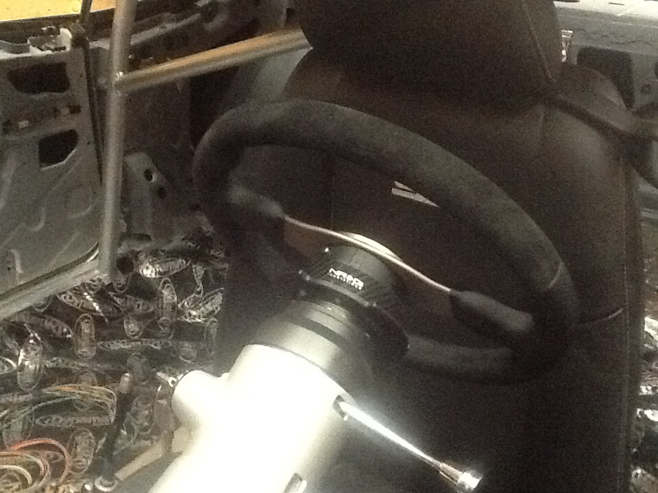

I did a lot of research on the subject. I trust advise from people that actually drive their cars a lot, like Sieg, for example. I was looking for a detachable wheel, for a number of reasons, like security and ease of troubleshooting under dash issues, with the wheel out of the way. I found a thread on here on this subject, and took his advice. Mine is an NRG short hub, with carbon fiber quick release. Wheel is a Momo Champion. It does push the wheel back towards you, but I actually like it, since the Momo wheel I have doesn't have a dish to it.
Release mechanism is very well built, and holds wheel tightly.
Here's some crappy pics...
Thanks Dad!!

Another view...

Thanks for the pictures,,
