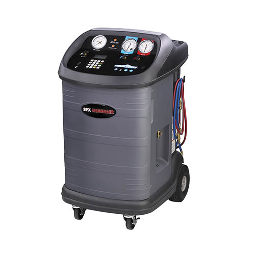

Anyone know about these machines? Just bought a used (barley) Robinair 17800B recovery / recycle machine for my home shop. It was bought from a closed down shop at auction so I am stuck with it so I need to get it working.
All of the fuctions start but does not matter if I am trying to recover, recycle, fill the unit from a fresh tank of 134 I get a HI-P (High Pressure) message and the function stops. Ive checked all the trouble shooting in the manual and talked to tech support at Robinair (They were no help other than offering a number to a repair man)
Ive hoping this is a common issue someone can give some pointers on. It looks near brand new and the run meter only shows 5 lbs of refrigerent has gone though the filter.
thanks in advance

I would check the filter anyways. I have heard contaminants can clog the machine really fast if they evacuated something nasty

My recovery machine that I use for commercial hvac has a small screen in the input line, I had a instance where I was trying to recover refrigerant and was getting higher than normal pressures and when I took that screen our and replaced it my pressures dropped significantly. I'd also look for a filter of some sort to clean or replace.
