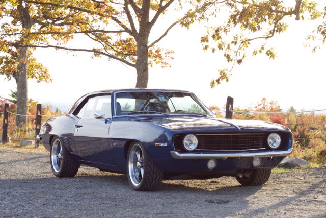

I am running -1.1° Camber, so mild but about right for street driving.
The picture is with my old spindle setup which was at least 1/2" further in with the 18x8 4.75 BS, 245/40's.
I can tell you that the Wilwood hubs alone are + 0.28" ea., plus whatever the hat thickness difference is.
