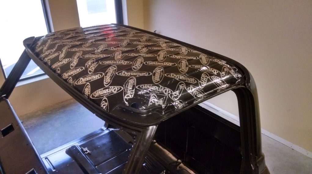

Dynamat between headliner and roof skin

Dynamat roof skin

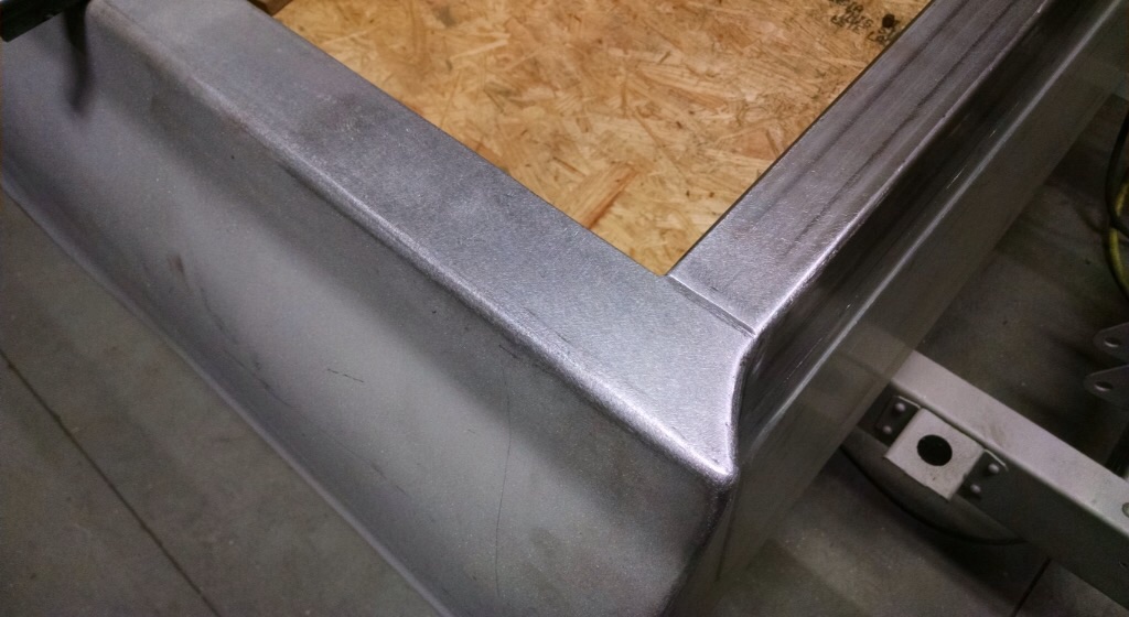

Squared up bed corners for flush mount toneau cover

Originally Posted by
Ambition Road
Going to be a very tight fit where the roof rolls down to the door, Just did it on a truck in our shop.
Musclerodz
I was prepared to remove a strip from each of the beads if nessesary but it wasn't a problem at all.

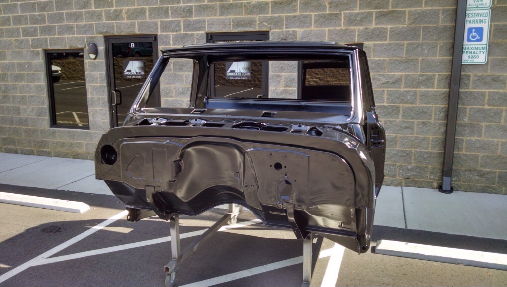

It's starting to look like a truck again. Got the bed and cab mounted and aligned, now on to fitting the doors and front sheet metal.

Slick work!
Like the dynamat in between the pieces
