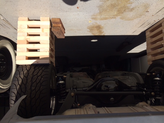

Old 05-23-2016, 10:39 AM
alvin3a alvin3a is offline
Join Date: Jul 2007
Location: Seattle WA
Posts: 11
Built these this weekend 17"x12" screwed together cost me about $45 and took about a 1/2 hr for each one. Which seemed like a long time but it was a lot of screws

Posts: 183
Default 2x4 stands
I went 16x12 i believe. I went just high enough where my big floor jack could get to the bottom of the housing. Stable as can be. No clue why the pics are upside down.....Buy a Mac they said.....
