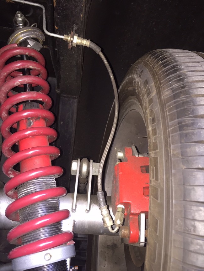

If it had happened 5 min earlier it would have been very bad. It reminded me of the blues brothers, go through hell and the car falls apart a few seconds after they park it.
The car handled as my mechanic described as a "fat girl on a skate board". Another problem he diagnosed for me was a very strange vibration over 50 MPH, he believes the past techs were trying to get rid of it by adding weight and dampening. Dyna mat all over the links and driveshaft. He found the transmission was tail down close to 5 degrees. The rear was also down 3 degrees. He said in order to fix that the trans tunnel and cross member will have to be redone to give us the proper drive train alignment. His goal is 0 degrees on the trans and -2 on the rear end. Then adjust from there.
The car also rode very hard. VERY!!
We found 800 LBS springs in front and 500 LBS out back. Going to switch to 550 front and 200 rear. He will reduce the rear shock angles to do this.
Funny you mention Ron, he supplied a lot of the parts we used.
There was talk about doing a 3 link but we ended up with a parallel 4 bar with a frame mounted watts link. He has done a few of these with great success and its explained that its better on a 70% street, 10% auto X and 20% cars and coffee car.
Using Ridetech brackets, Ridetech coil overs, Spohn's narrow spherical's rod ends, Ron Sutton watts components, grade 8- 3/4"/ 5/8" hardware, All star performance links, QAI tube adapters and 1 1/4" .120 wall tubing and 3/16" custom brackets throughout.
I didn't like the gear noise coming out of the Williams rear so we are going with a Moser 9 housing custom fit along with 33 spline axles and true track 4:11 N center. Should be fine and quieter for me.
here is the preliminary fitting. He ended up putting in another pair of parallel 2x3 .120 runners to mount the lower links 2" out on each side to make the links sit out wider. This will put the coil overs closer to the tires. not sure why he wanted to do it but I am trusting his actions. He added a few details to sit lower if I go air-ride in the future.
Now that he has his info he can sit on his computer and go over his 4 link calculator.
