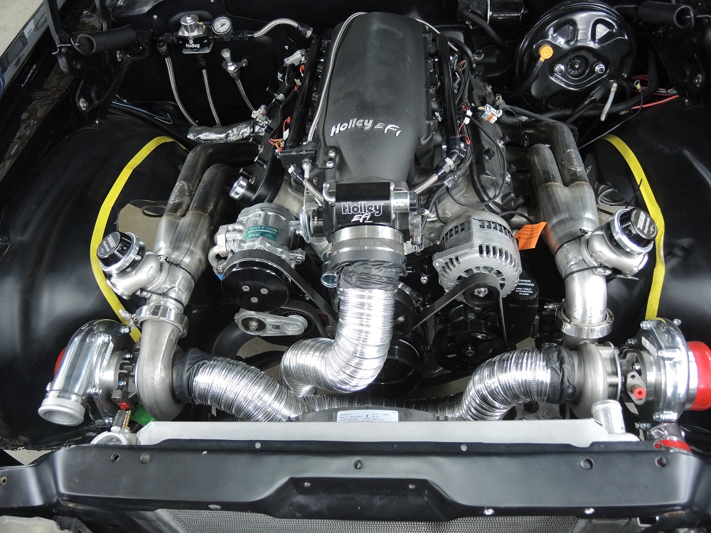

Default Updated photo Turbo Routing
Here's a quick pic. No, we're not staying with the Lowes corrugated piping... yes, wastegates and BOV's have been plumbed in since then. The Vintage air Frontrunner is the ONLY reason I can run this setup!!! Beautiful and functional components!! More to come.

Nice work. Good idea on the mock up materials.
