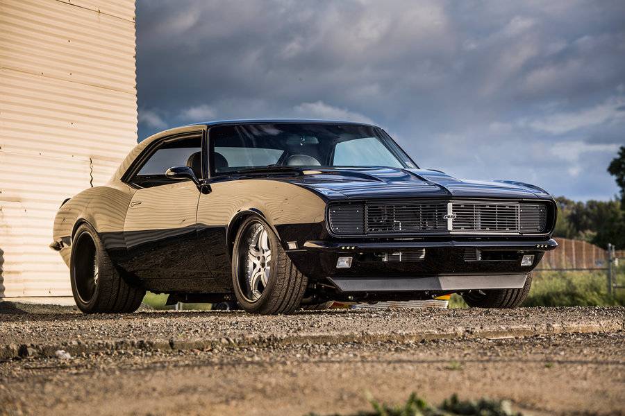

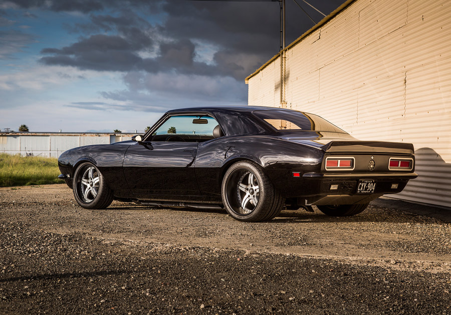

Hey Guys, be sure to check out Project Blackjack on Boze Tach wheels in the current issue of Chevy High Performance magazine on the newsstands now. Here's a few of the images from the feature. Photos by Tim Sutton.

Looks great! Is that grill a one time custom?
Yes, it's made by Eddie Motorsports.

We made minor modifications and painted the center section. Outside of that, you can call them or us and we can put a custom spin on it if you like.
