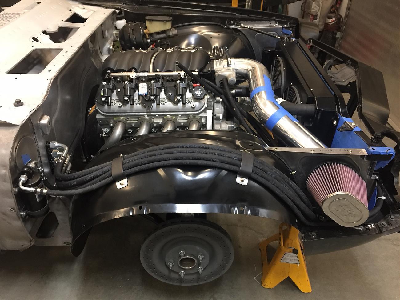

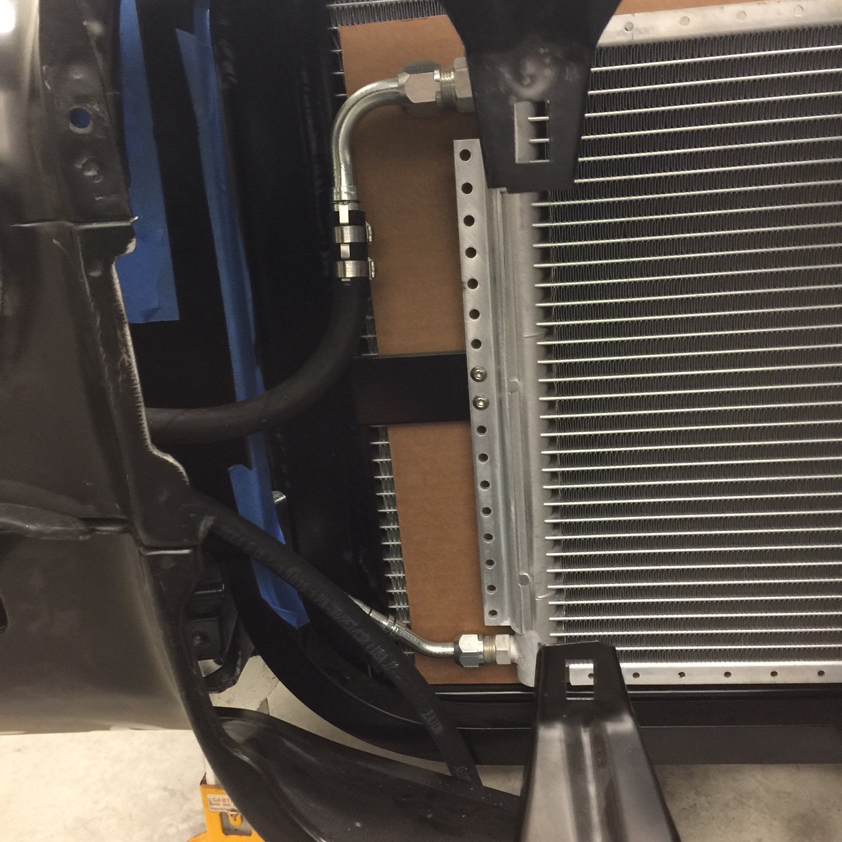

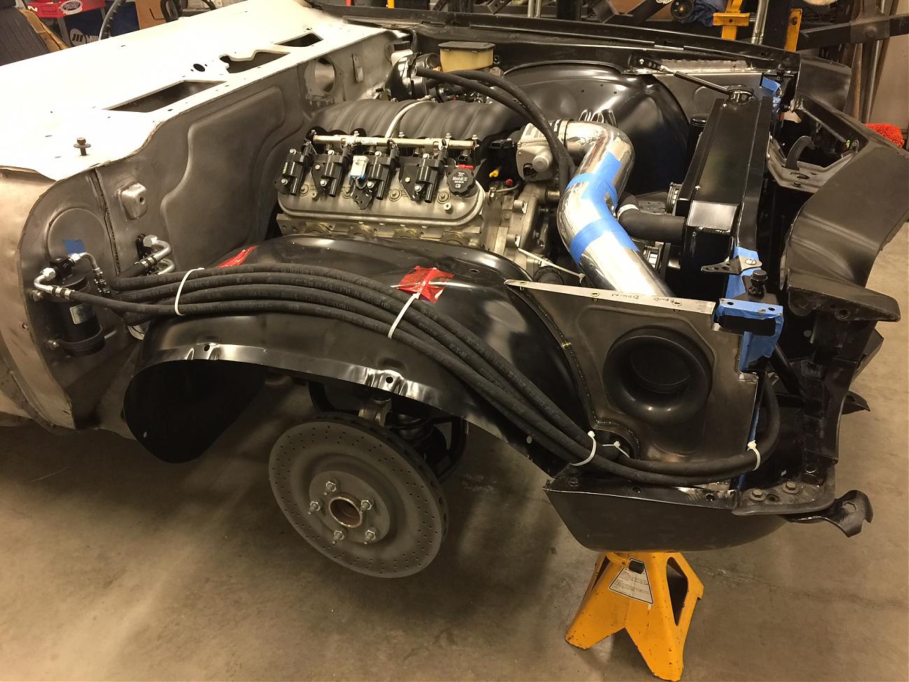

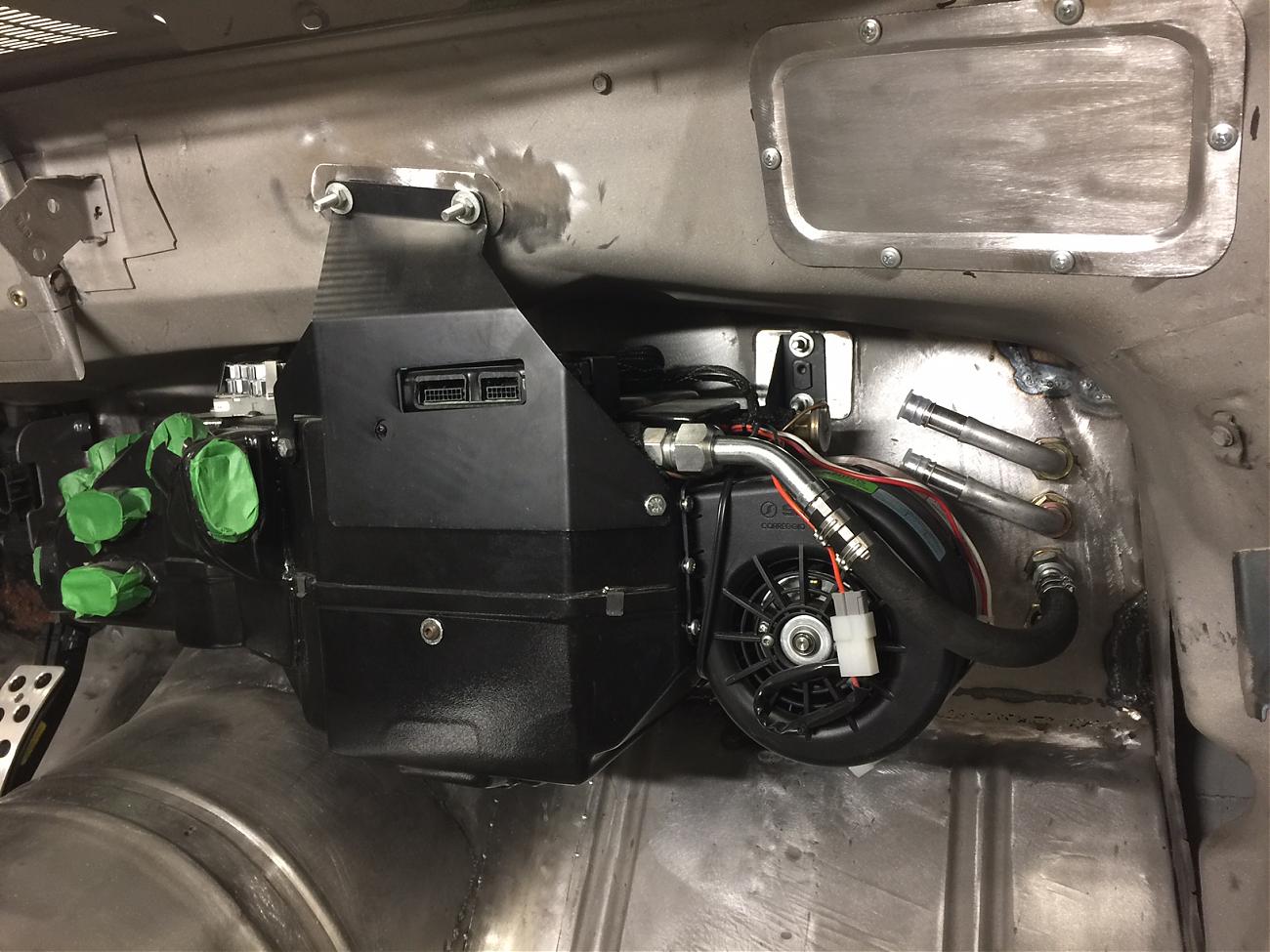

I started working on my AC plumbing, I went with EZ clip hose and fittings. I bought everything from Hose Warehouse, they seemed to have the best prices. So far I have everything mostly routed. There's a few areas that I need to sort out, like the bulk head lines under dash and the heater lines that go to the water pump. These areas are very tight.
I'm also second guessing my air filter location now, I couldn't run the air filter on the drivers side because my remote oilfilter in taking up that spot. I'm not sure if the heat from the AC and heater hoses with affect the air intake but I will most likely make some holes in the lower front portion of the fender liner.

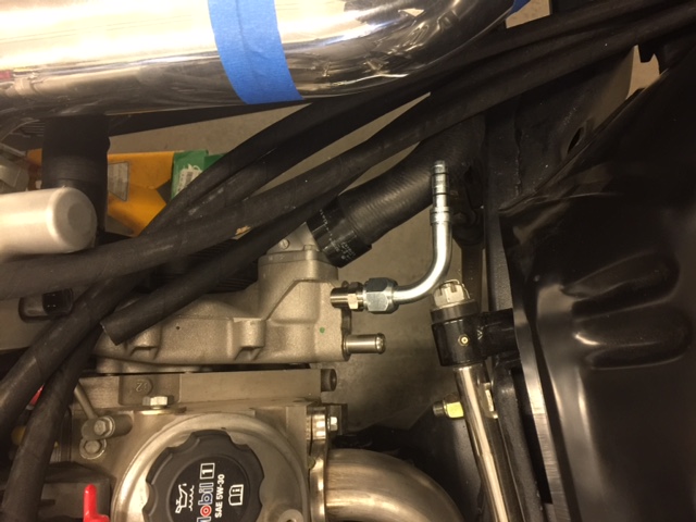

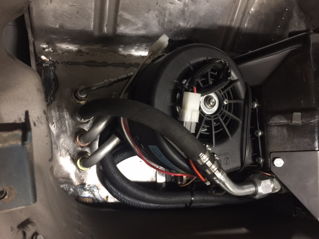

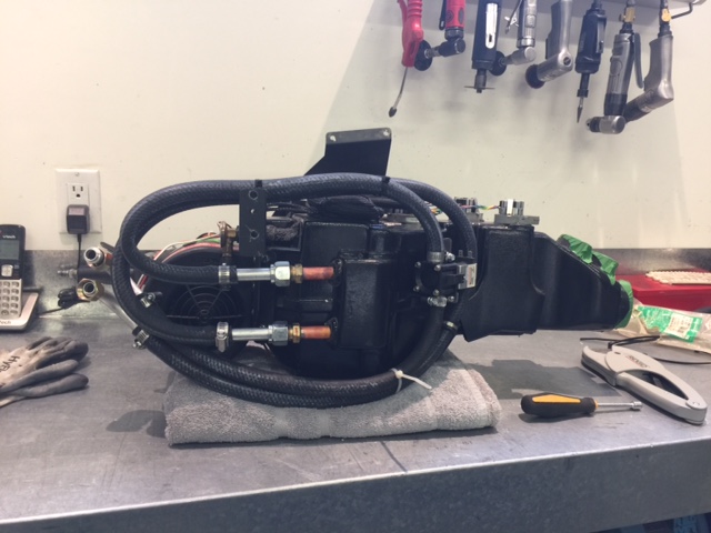

I made some small progress on the vintage air unit under the dash. Not exactly how I wanted to route the lines but I think It should work fine. The only part of the plumbing that's not looking too good is the water pump, heater line ports. I'm going to be ordering the Drive Junkies Accessory drive, when I free up some funds. Once I get to that stage I'll see what I can come up with.
