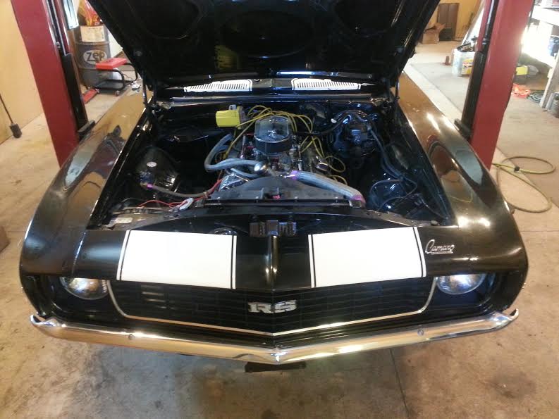

Well,
I'm making this build thread to start documenting my project. I've already asked a bunch of questions here: https://lateral-g.net/forums/showthread.php4?t=44069
but it's time to start doing something.
I purchased a 1969 RS Camaro a few weeks ago and I'm accumulating parts. Unfortunately, I'm on a pretty tight budget and my wad is mostly spent for the moment.
So far I have in my possession or have ordered:
Engine/Trans/ECM/Harness from a 2004 GTO
Holley 302-2 Oil Pan
Tanks inc tank with sending unit and 400lph Walbro
Manual brake and clutch pedal
Energy Suspension body mount kit
And misc other stuff I needed
I'm going to need some engine mounts and I'm leaning towards the Dirty Dingo sliders but haven't decided. I'm not going to be able to afford headers at the moment and would like to use factory manifolds; however, I would like some mounts that would work with headers in the future which is why I'm thinking the adjustables would be a good idea.
The other major thing I have to decide on soon is the wiring harness. I'm thinking about modifying the stock harness myself but I'll admit that it's a daunting prospect so any help on that would be awesome. Also, any ideas would be great on whether or not it's a good idea just to send out my ECM to have the modifications done or if it's worth it to buy some tuning software myself.

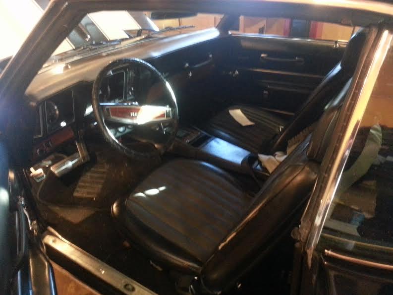

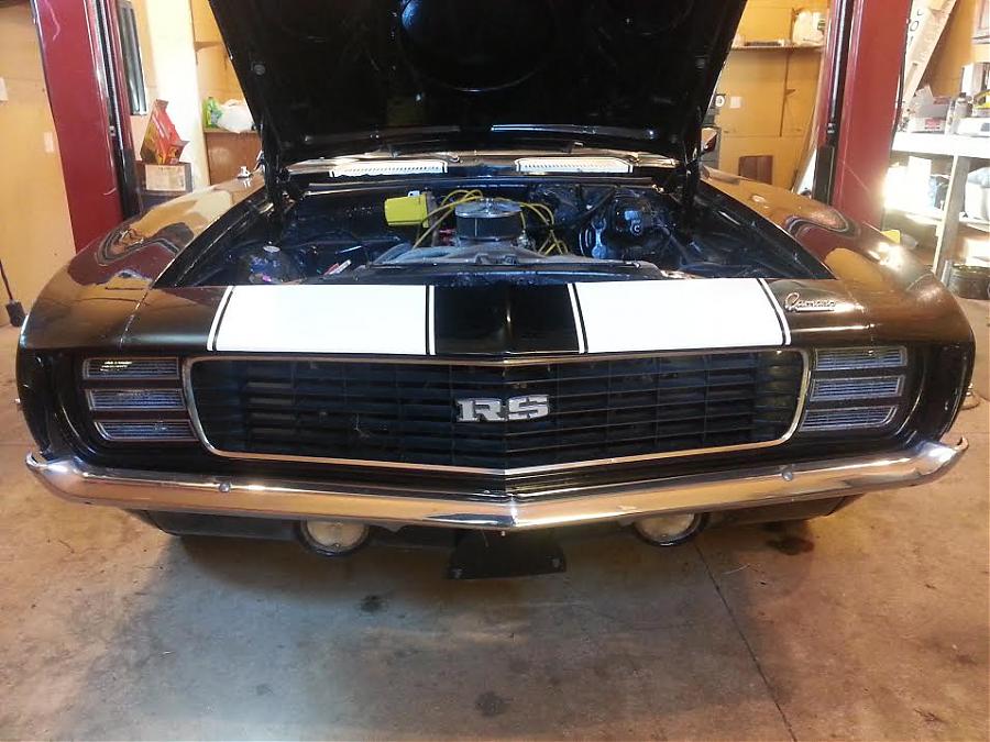

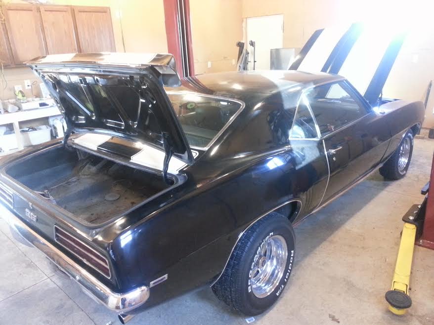

Anyway, here are some pix about as she sits at the moment.
I already have front discs and don't plan on messing with the suspension or body too much until a year or so from now when I've got enough money saved up again.

The body has some bondo in it and a few rust bubbles in some of the normal spots but is otherwise and overall quite solid including the floor, rockers and trunk. The rear quarters have been replaced as well.
