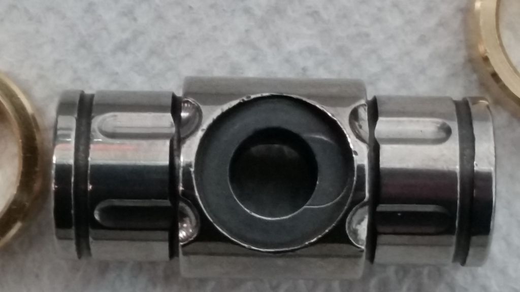

For anyone that cares and is still following this thread. I received the Straub trunion upgrade kit, the shafts are REM finished and have oil groves machined in them, the shafts also appear to be harder based on a simple test we did using a spring loaded center punch.
