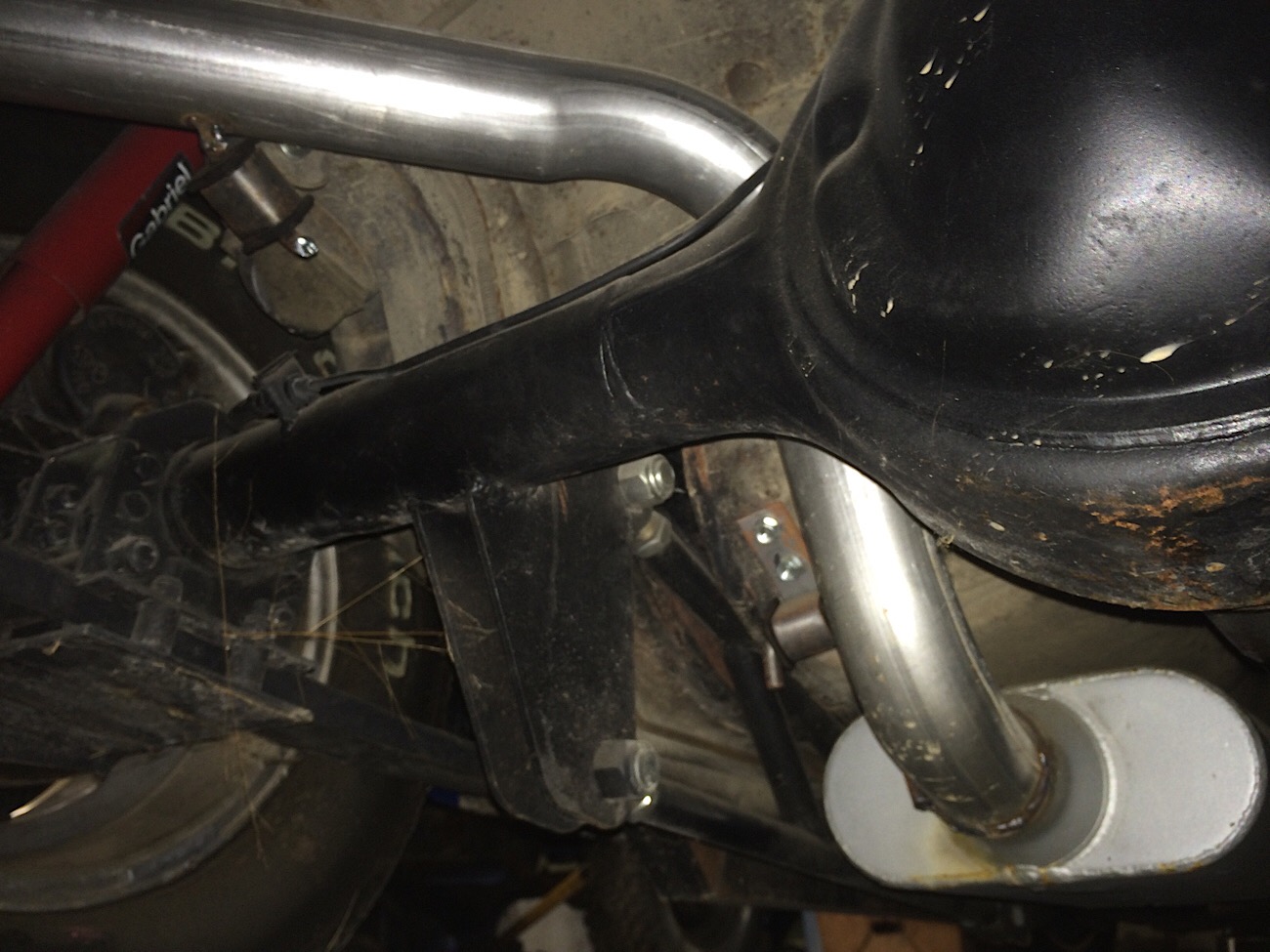

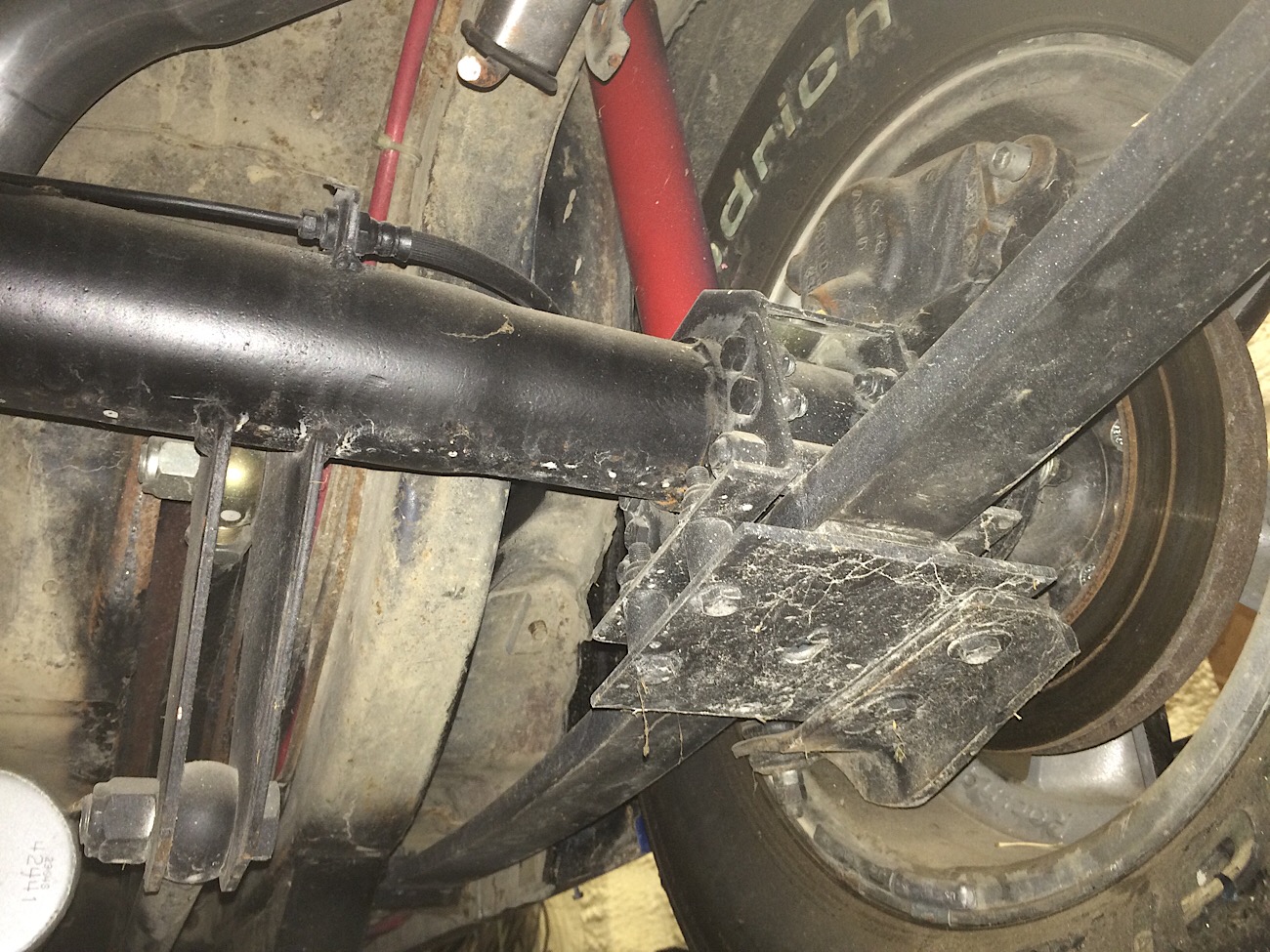

Thanks everyone! The bmr setup looks nice! Here are some pics. Not the best as I haven't had it on a lift yet. Yes the framerails are intact and there are leafs on it, they are the corvette mono composite ones.
I saw a bolt on 4 link from ride tech that's reasonably priced, would I be able to cut out the ladder bars and install that? I don't need it to be the best road racing car just fun to drive and as you all mentioned I am sure that I wouldn't be able to drive to the cars potential anyways. Thanks again!

Since your car is already set up for leaf springs I'd keep it that way. I'd get the new ridetech composite leaf springs and call it done.
Take off the ladder bars and brackets of course.

It looks like he already has composite leaf springs...

X2. Pull the ladder bars and maybe upgrade the shocks and see how it feels.
Don

Ben, thanks for all the info. Not sure exactly what I want but I don't really plan on autocrossing it any time soon. The speed tech stuff looks really nice.
I think initially to save some mullah I will do as the guys suggested, take off the ladder bars and see how it goes.
Do you all think the floating brackets will then be an issue? Any way I can just weld the floating brackets instead of having to take the whole thing off to weld new leaf spring blocks?
