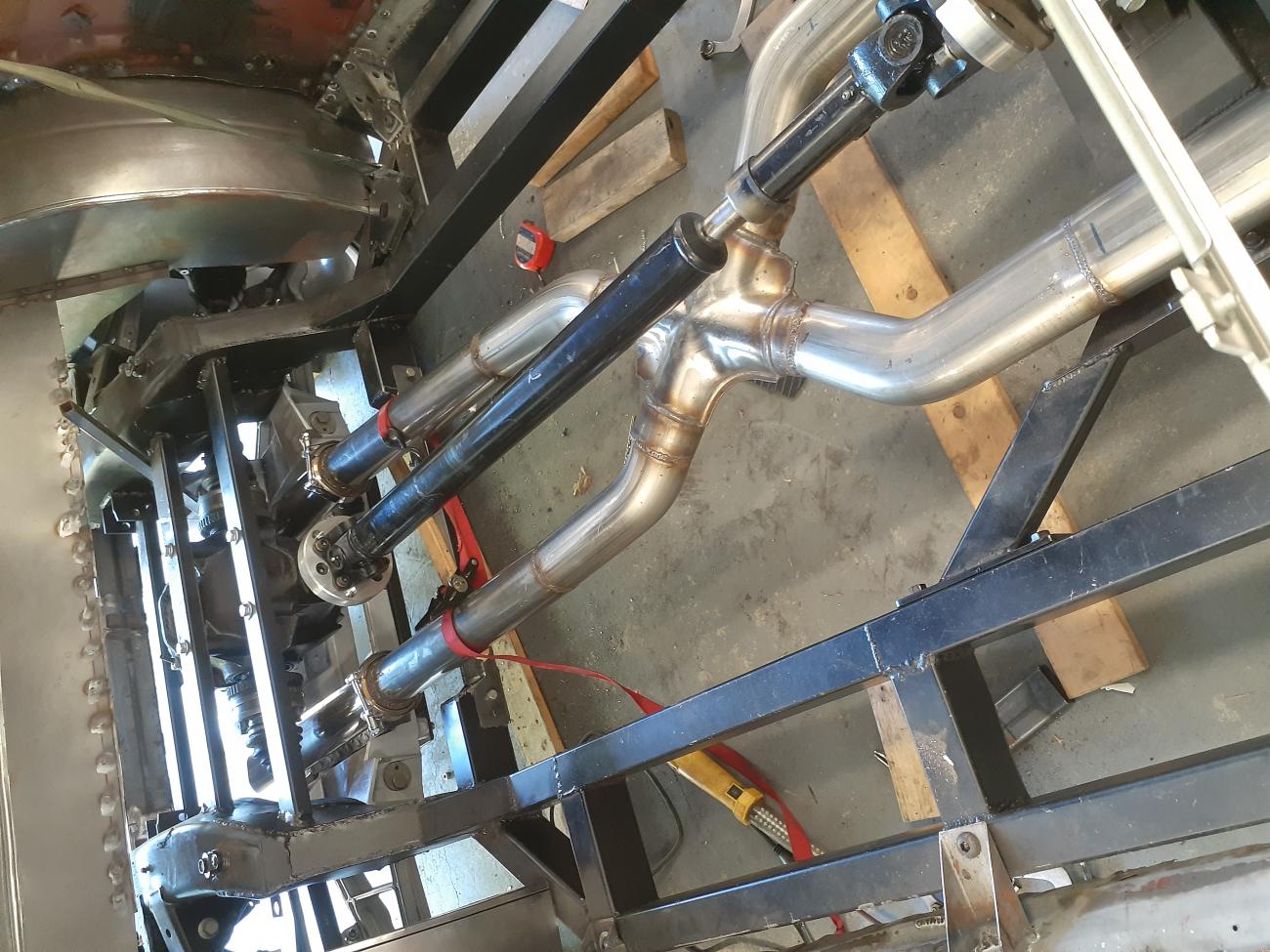

I got the bulk of the exhaust built. 304 stainless, cut and weld. Still needs to be ground and maybe polished. It came out better than expected. I still need to figure out how it will terminate. I like the idea of building some sort of diffuser that will also house a single backup light.

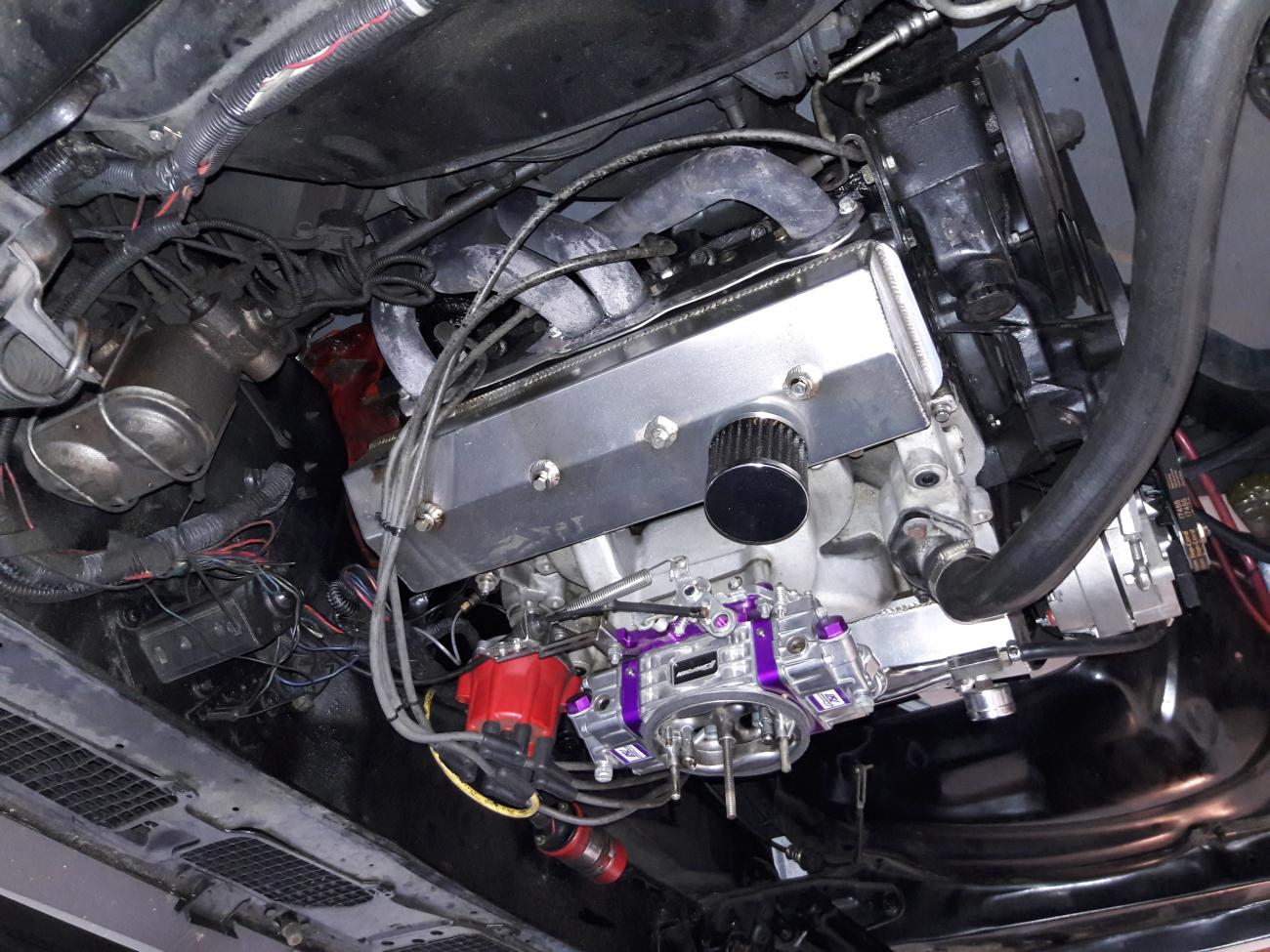

And a few more to bring it up to date.

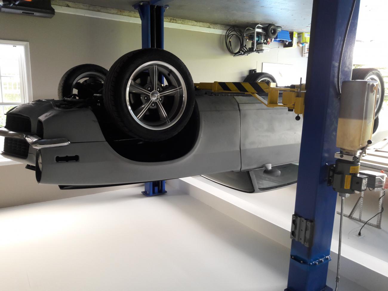

Im not really sure what happened, but the car is really rubber side down ion real life.
I fixed them, never seen upside down before lol.
