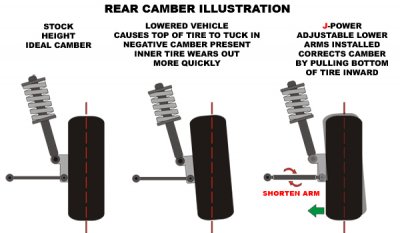

Found this online, would a shorter lower control arm solve anything?

That depends on exactly what you are working on and trying to accomplish. Ideally - the chassis would be set up at ride height and body set at the desired position on top of the chassis.
I suspect most people here have this image in their head based on what you've asked. It's not clear what type of car you're talking about, how much you want to lower the car, why the car is or needs to be so low. Or, what you want to do with it once it's that low.

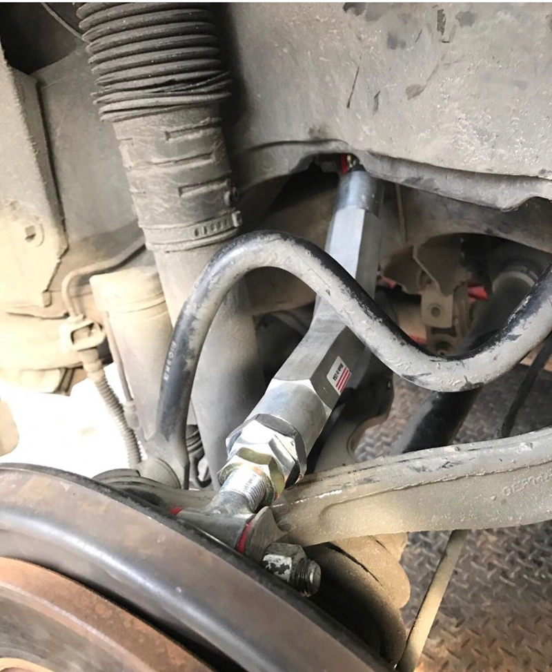

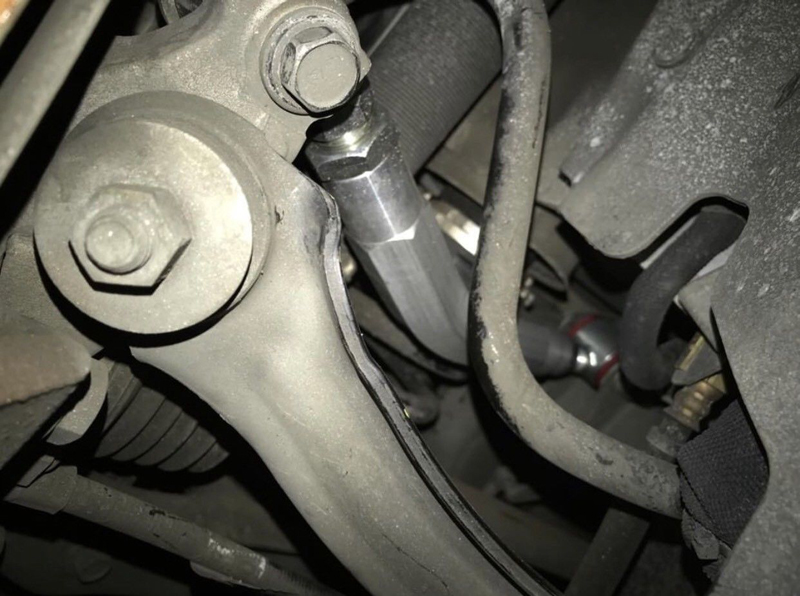

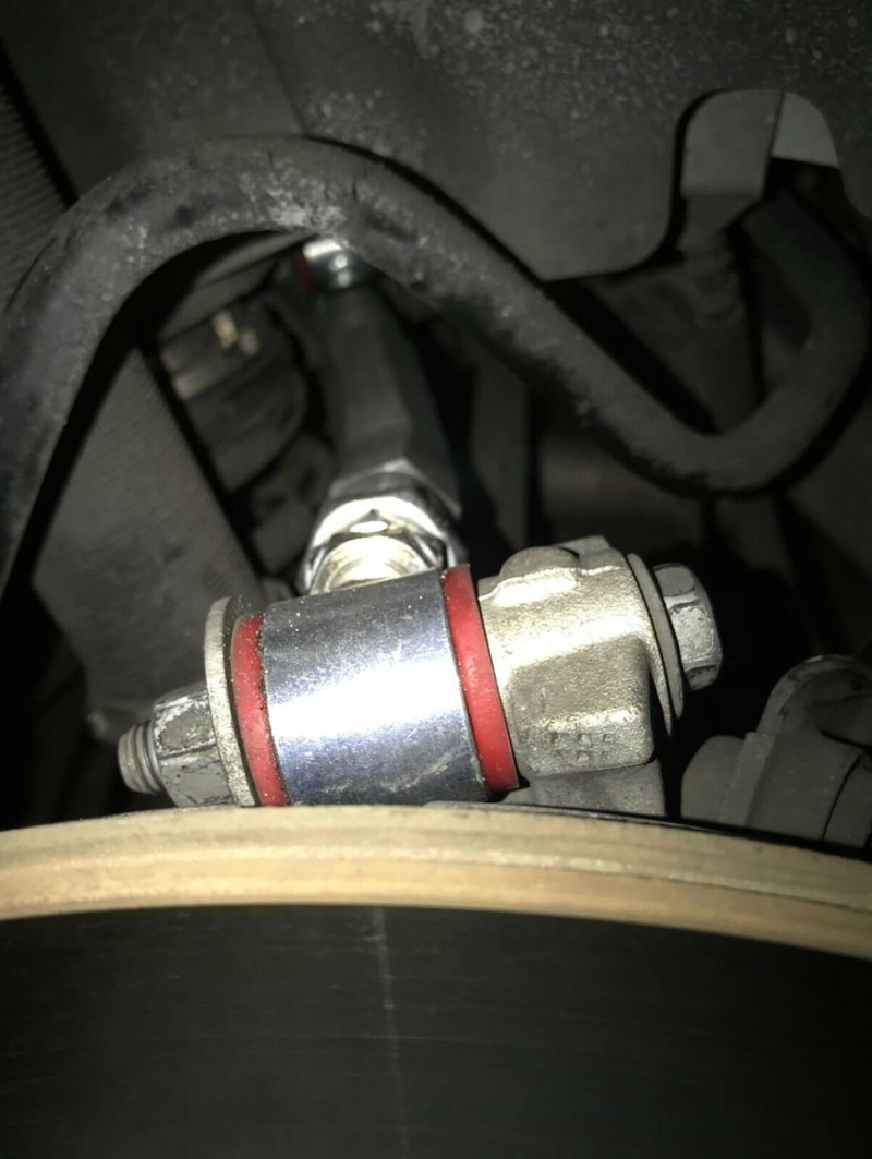

Great information Bret! Thanks for your reply! What you said makes perfect sense. When I was trying to research all of this I came across this kit online called "Rear Adjustable Camber Thrust Arms Combo Kit Link". I think this is goes with what you are saying about a "moveable upper control arm mount that you could actuate maybe with a ballscrew or hydraulic mechanism."
They have several different kits and I think this goes with what you're talking about?
