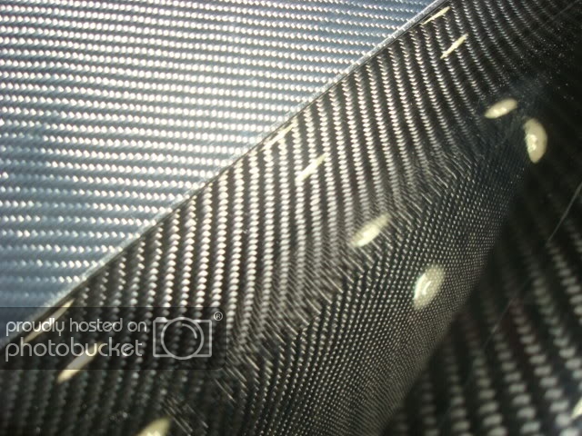

I have one of Albert's carbon shaker / Trans Am hoods sitting here at my house at the moment. It was an early one that Albert built and had on his own car. He had installed the Aerocatch hood latches in the hood.
I bought the hood knowing that the weave pattern wasn't perfect on this one, but it still looks very good. He did a great job of mimicking the original underside structure of the hood. If you cleaned it up and painted it, one would have to take a second look to realize it's not the original metal structure.
And the hood is amazingly light! I have a VFN fiberglass hood on TOW, and I've moved both hoods around a lot. I thought the VFN was light, but it's almost heavy compared to the carbon hood. Truly a surprising difference.

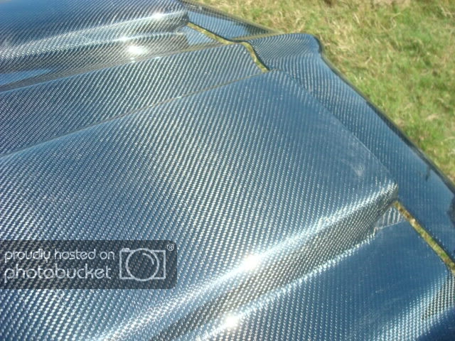

I've had Anvil's 100% CF hood on my Formula for over 10 years without issue and I constantly get comments on how great it looks!
I also have their CF nose, lower front valance, trunk/spoiler and the rear filler panel between the taillights on my car... again for over 10 years with no issues.
I don't think you can go wrong with Matt or Albert's products honestly!
Anvil's Formula hood is a quality piece... as are all their other products we put on my car! HTH

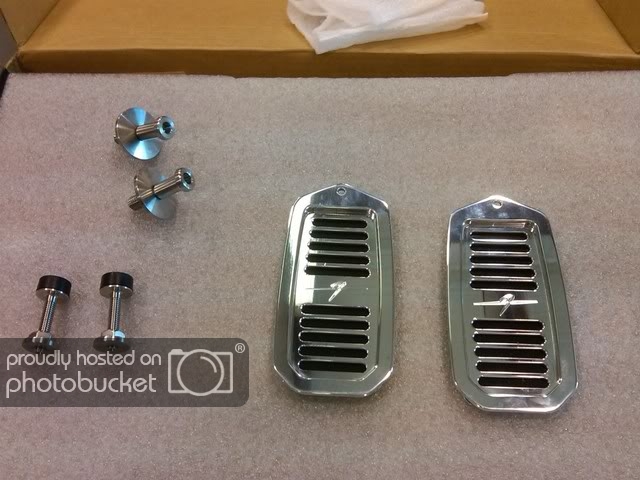

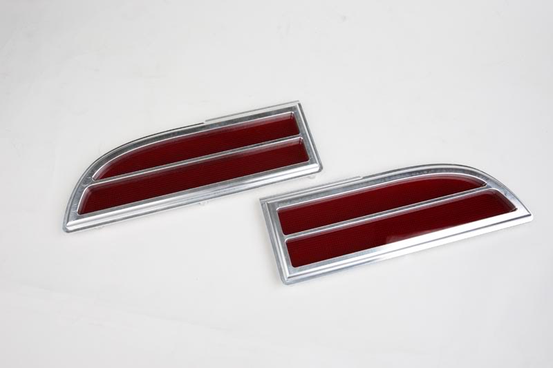

Hood hinges and most of the other billet on my car is from Fesler!
Hood hinges, door jamb vents, door strikers, hood adjusters, fender braces... 7" halogen headlights and billet 70-73 Firebird tail light bezels!
All high quality stuff with no issues for over a decade!
I highly recommend them for your Camaro!
