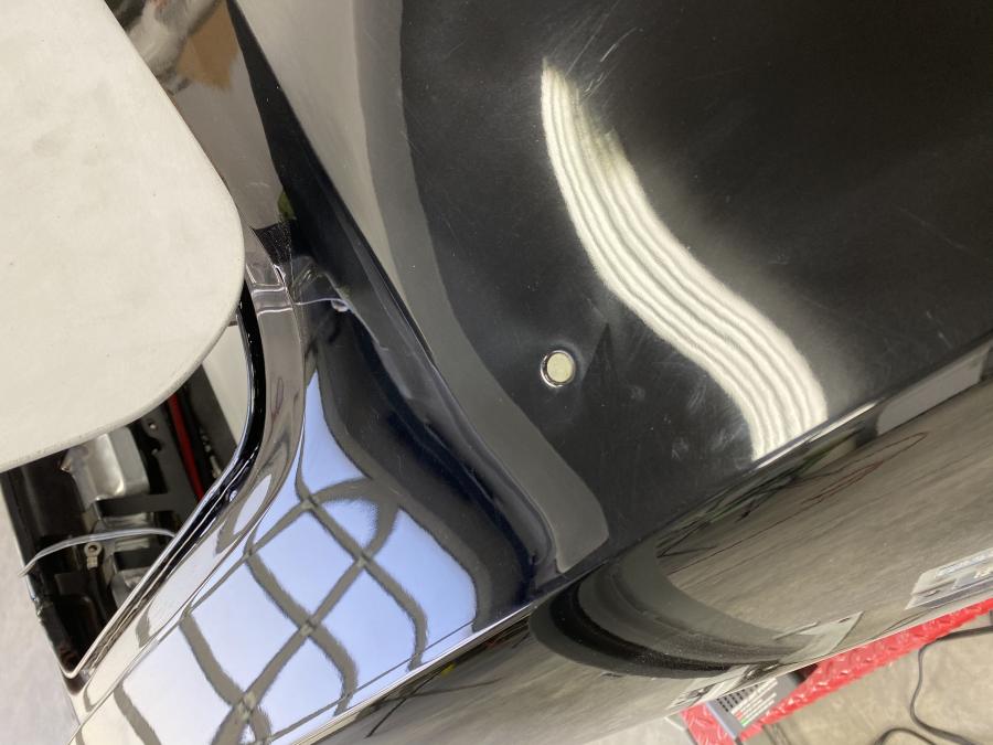

I believe this is the look you are looking for. The top of the mast has not been painted body color yet.
That's it..
Is this your car?
Do you know what antenna was used, more pictures of underneath?

Originally Posted by bd8134 View Post
That's it..
Is this your car?
Yeah, that’s my car under construction. I purchased the power antenna at my local O’Reilly‘s auto parts store. Nothing special. Just have to make sure that the top of the mask is flat or that you can file it flat so it matches the top of the fender. Mine is mounted in the trunk Using a mount that I fabricated.
