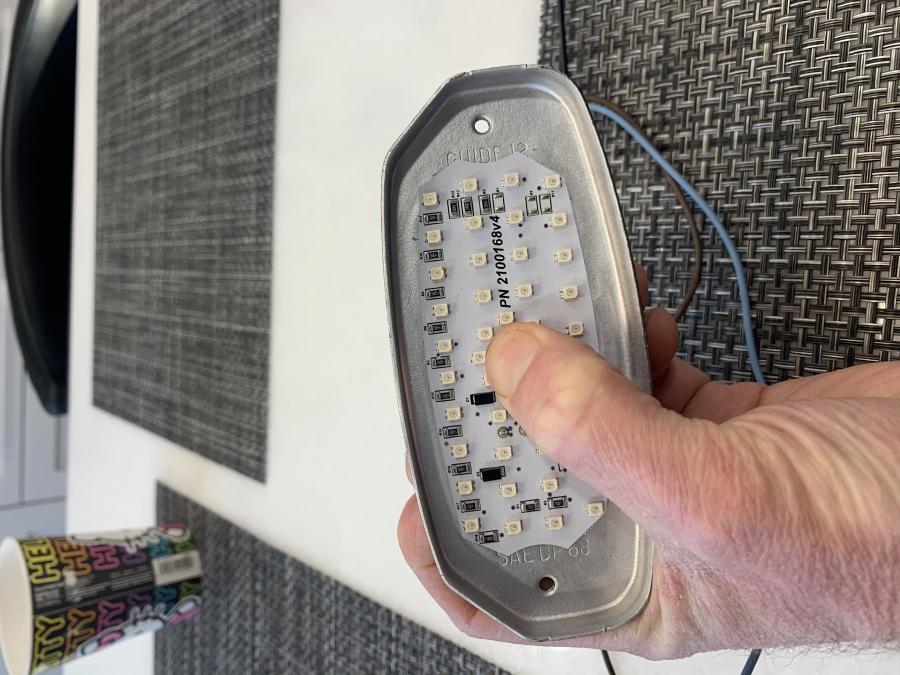

wow this came up just as i started working on mine and am having the exact same mounting issues? how did you center attach and have the gasket not block any of the led's?

Do you have any pics? I have digitalis in the front and rear of my car.

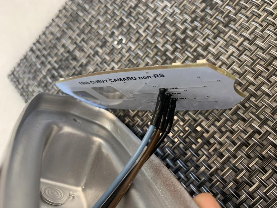

So before they used to extend all the way out to the screw holes. Now they just kinda float. The rear sucks too because it is so far off center it makes it hard to move them around. And finally when I put the gasket on it blocks a whole row of leds.

Can you wrap the gasket around it? Would that hold it?
