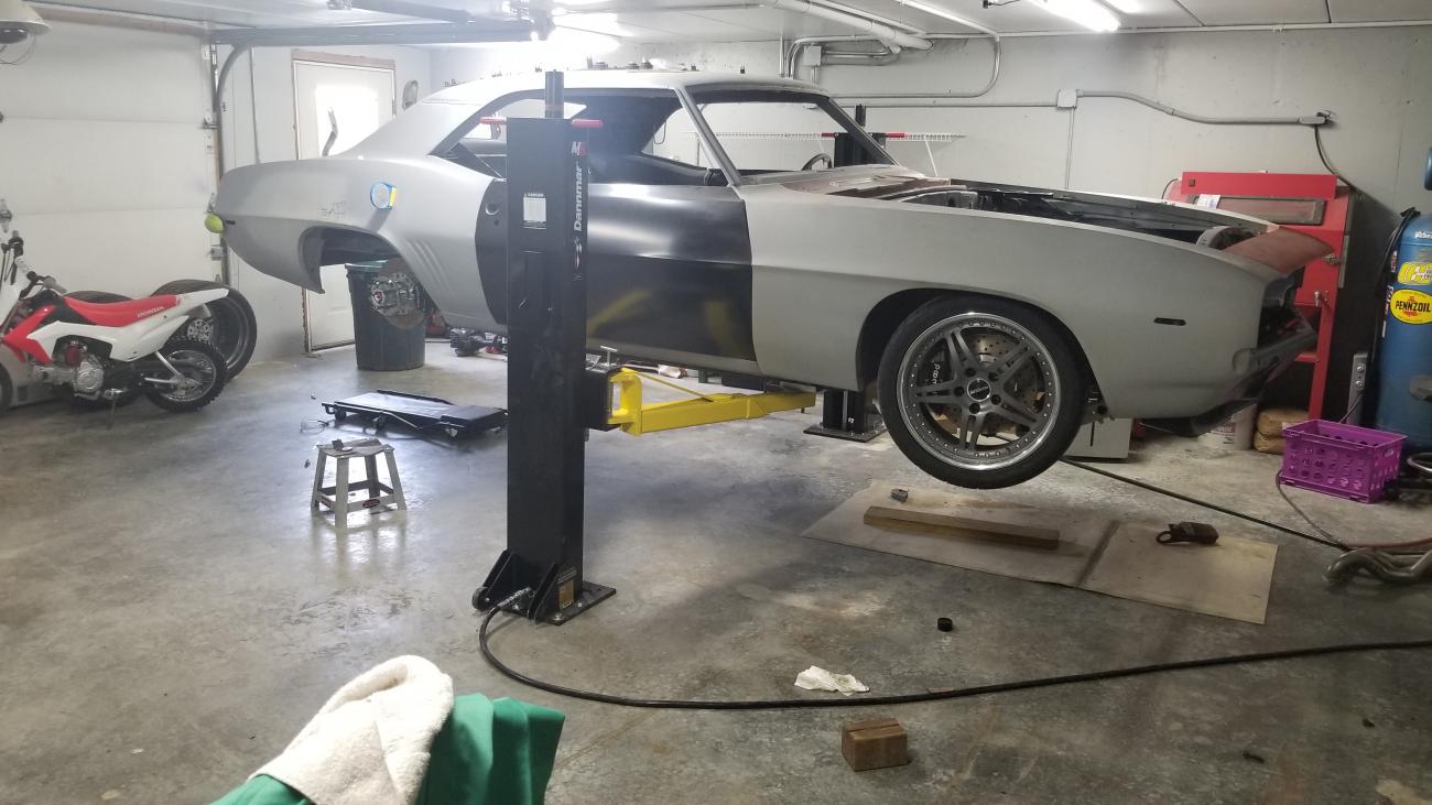

My plan is to tuck the lift off to one side so I can have a body on it and hopefully work on the chassis on the side of it. It will be tight in my garage, and may have to do some shifting of shop tools down there. I definitely wanted to leave plenty room to the side of the one side of the lift though for assembly room and just area to lay things to the side if needed.

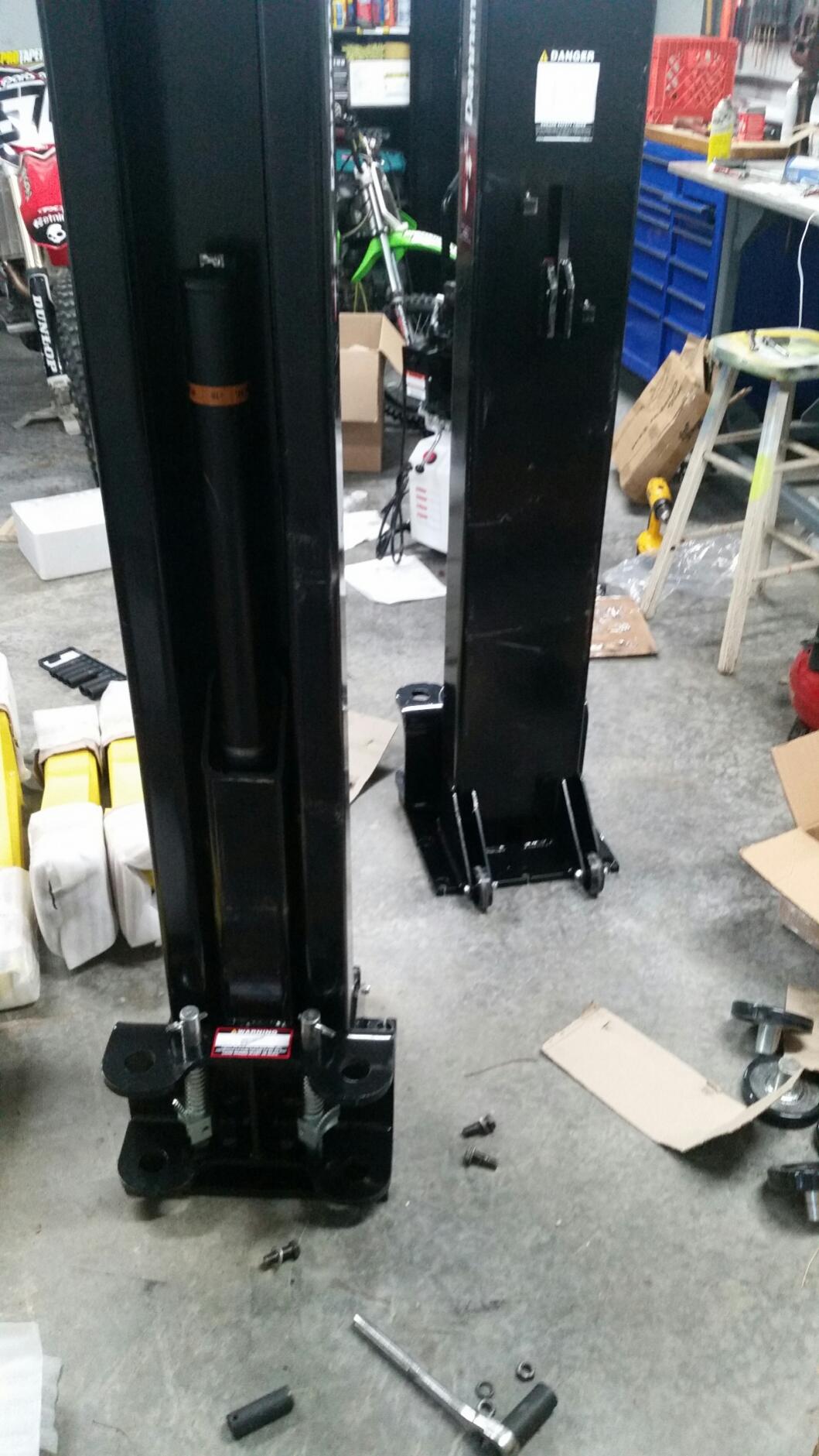

The lift itself was unbolted and began putting everything together. The power cart went together first. There were two holes that weren’t drilled in the cart, but it was a 5 minute fix so not a big deal. It seems nice and sturdy when bolted together.
Just for peace of mind, I pulled the manufacturer supplied Teflon tape off all fittings and re-taped them myself. I had seen several posts of people with leaking fittings (which usually can happen due to messed up Teflon taped fittings or just weren’t tightened enough), so this way I know the tape on the threads wasn’t compromised from being shipped halfway across the country.
NOTE: I had read before, and can see it now in person. BE CAREFUL when standing up the posts so the lift head does not slam down on your fingers. As long as it is slid down and through the cylinder, you will be fine. It would not feel good if you don’t do this though and have your hands in the wrong place.
The lift posts are not too bad to move around at all. They and the power cart roll easily. Hopefully tomorrow night I will be able to mark my post locations and get some anchors set in the ground. I opted for the standard Wej-It anchors. There had been complaints about a previously incorrect install method to install these listed, but by reading though that section, it appears the correct method is now in there using a sacrificial bolt and nut. I will then get the lines hooked up, get some oil in there and start bleeding the cylinders.

For your Camaro ,what spacing did you set your lift up at?
Good morning. I can double check tonight. Please remind me if I forget.
I like the lift though, and it was my only option with low header height.
