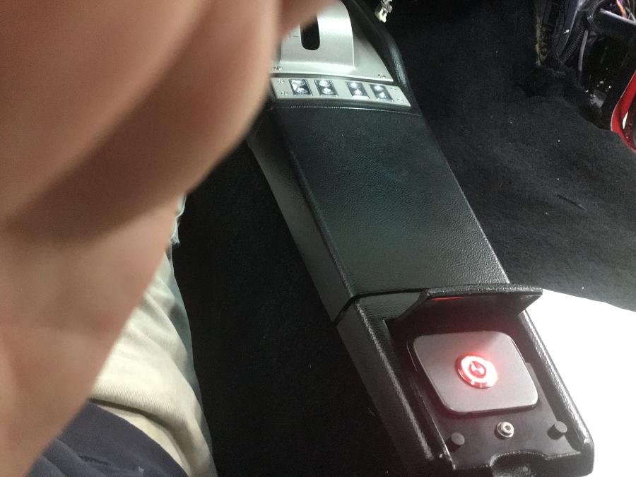

1. Buy a momentary button that has at least 4 amp capacity.

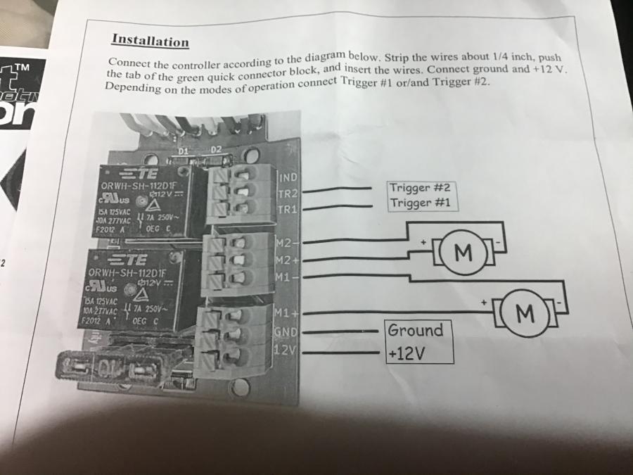

I went with Billet Automotive Buttons out of Australia because it’s backlit and custom laser etched. See pic and schematic drawing. Works perfectly.
2. Go to TimersShop.com. and buy their exhaust cutout controller.
It is an excellent controller and is tricky to wire the terminals.

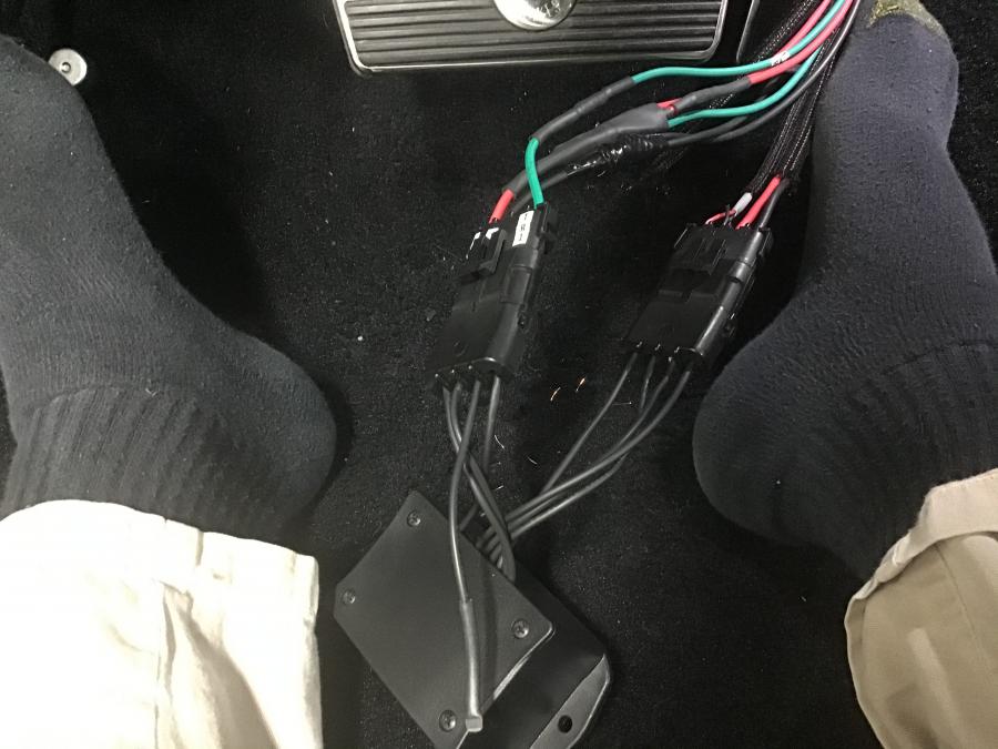

TIP: solder tin 18awg wire about 5/16” long and stab it deep through the opening. Anything larger awg won’t stay.
See pic and schematic.
Note in pic that we used weatherpac connectors because we wanted to upgrade wiring beyond controller to16awg with sxl insulation.
