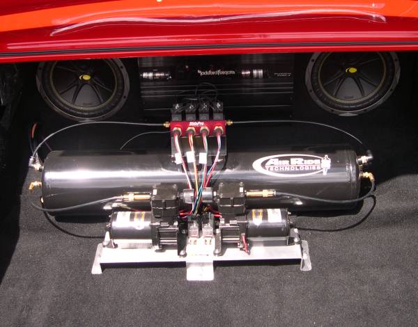

No problems here, other than if it sits over a month it might leak down a little.
This is on a 67 Chevelle.
