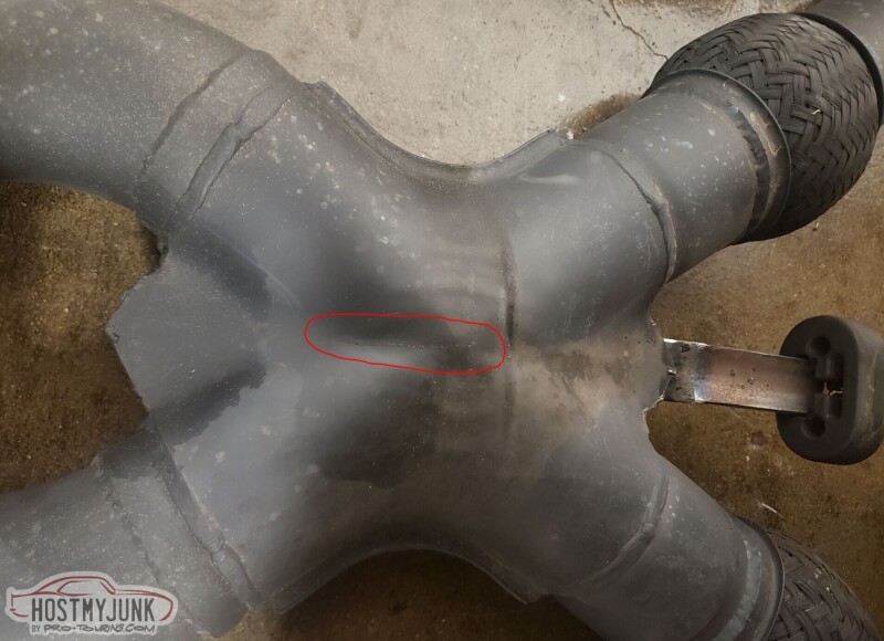

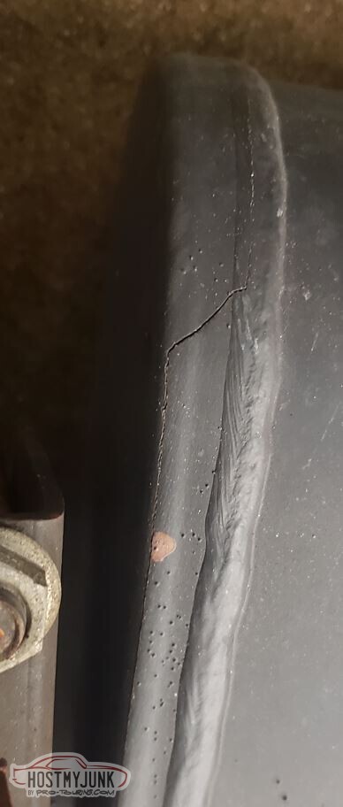

To my disappointment, each of these failed, IMO, miserably. The Dr. Gas part cracked, as did the Magnaflow X-pipe. The back caps of both sets of mufflers cracked most of the way around the perimeter weld and were missing nearly all of the noise absorption material.

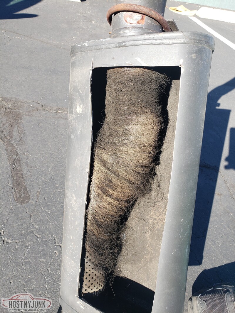

Both muffler aft end caps have cracks most of the way around:
X-Pipe has an axial crack on both sides. There are flex joints ahead of the X and it is supported by the rubber hanger.
It's not known how much packing was originally there, but it seems pretty light with lots of open perforations. The prior set of Magnaflows were the same way when they came out:

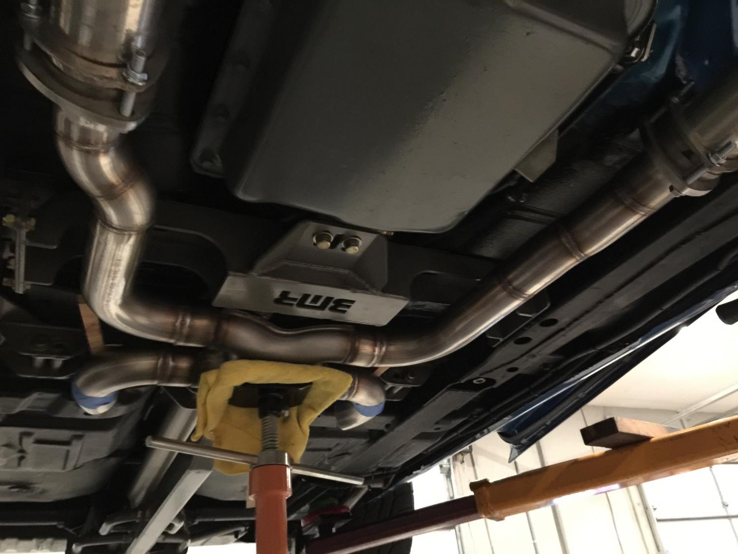

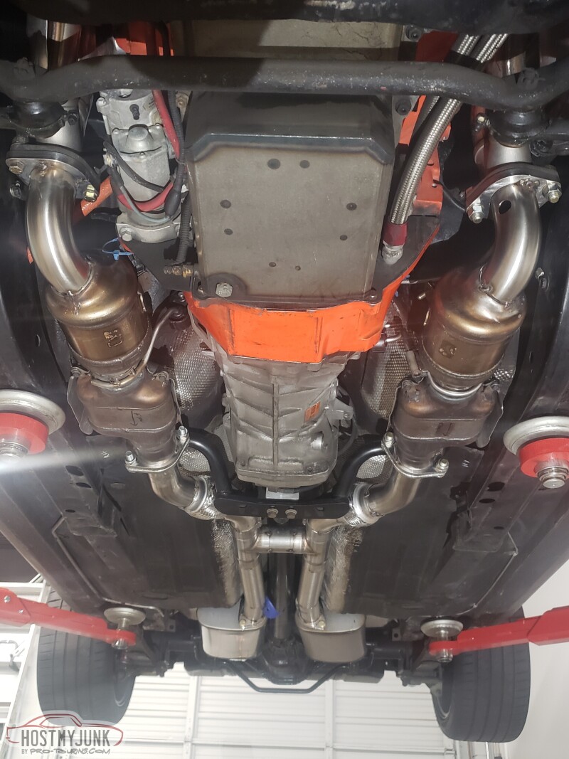

The new setup:
  • LS7 Z28 1-3/4” tubular tri-Y shorty headers, including the OEM heat shields.
  • All four catalytic converters from a 1k mile 2021 ZL1. I'll trust OEM validated 650hp rated parts vs. anything in the aftermarket.
  • 2-1/2" flex joints
  • 2-1/2” stainless exhaust, HD H-pipe, feeding big 18” x 9” stainless steel mufflers.
  • Full tailpipes exiting out under the rear bumper.

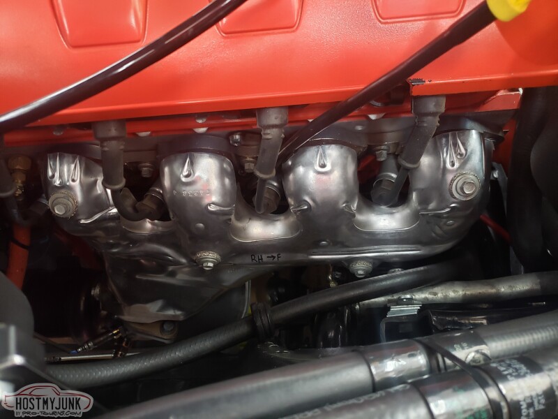

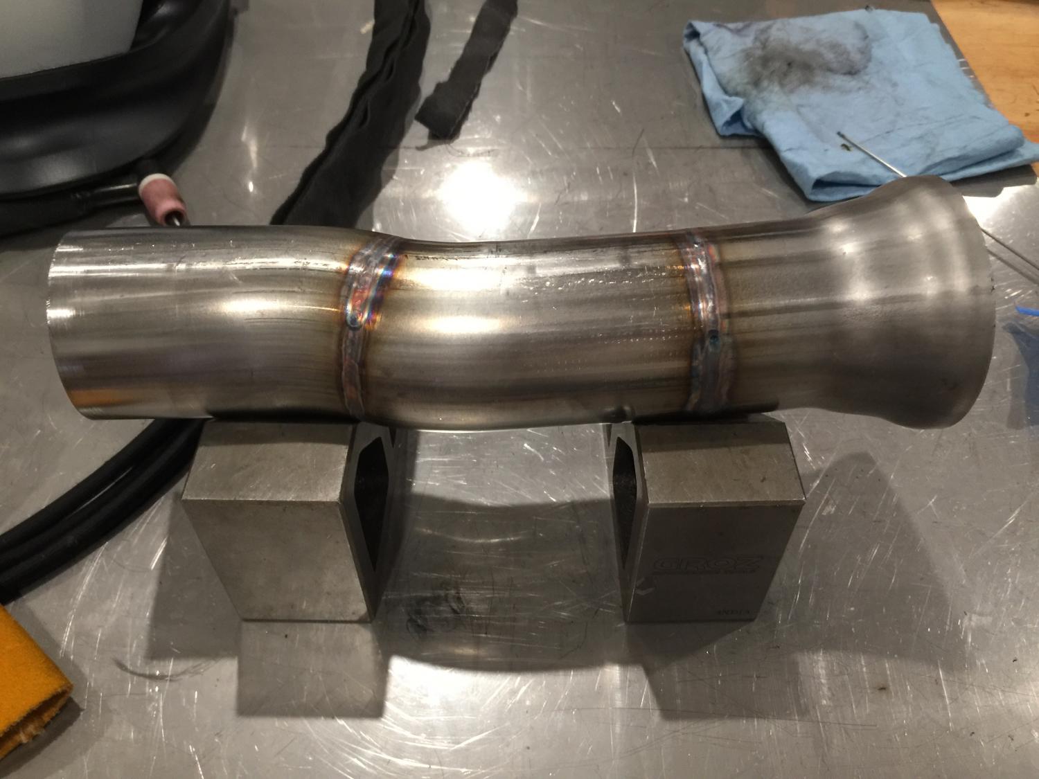

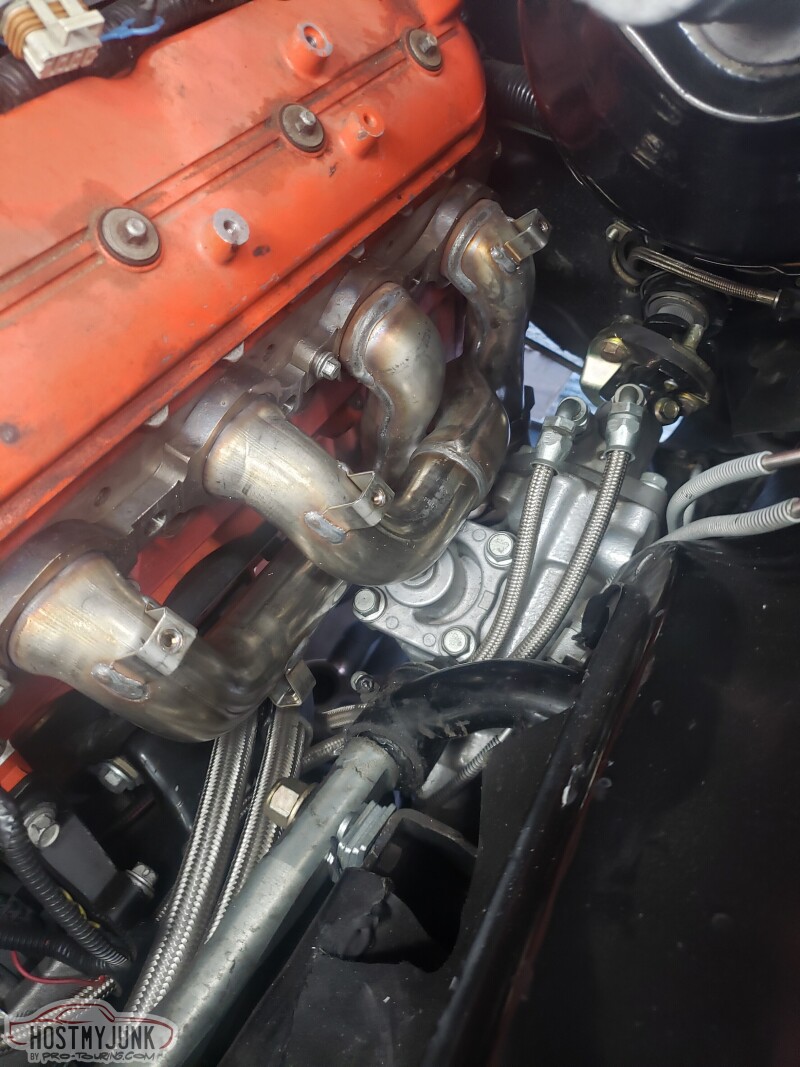

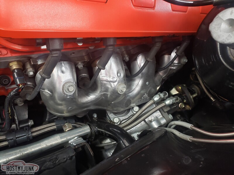

With said headers in hand (thanks to a fellow member who had a new take-off set available), test fitment on the passenger side could not have been any easier. It dropped in from the top without issue, the heat shields bolted on, and stock ACDELCO spark plug wires and aluminum shields went on just like OEM.

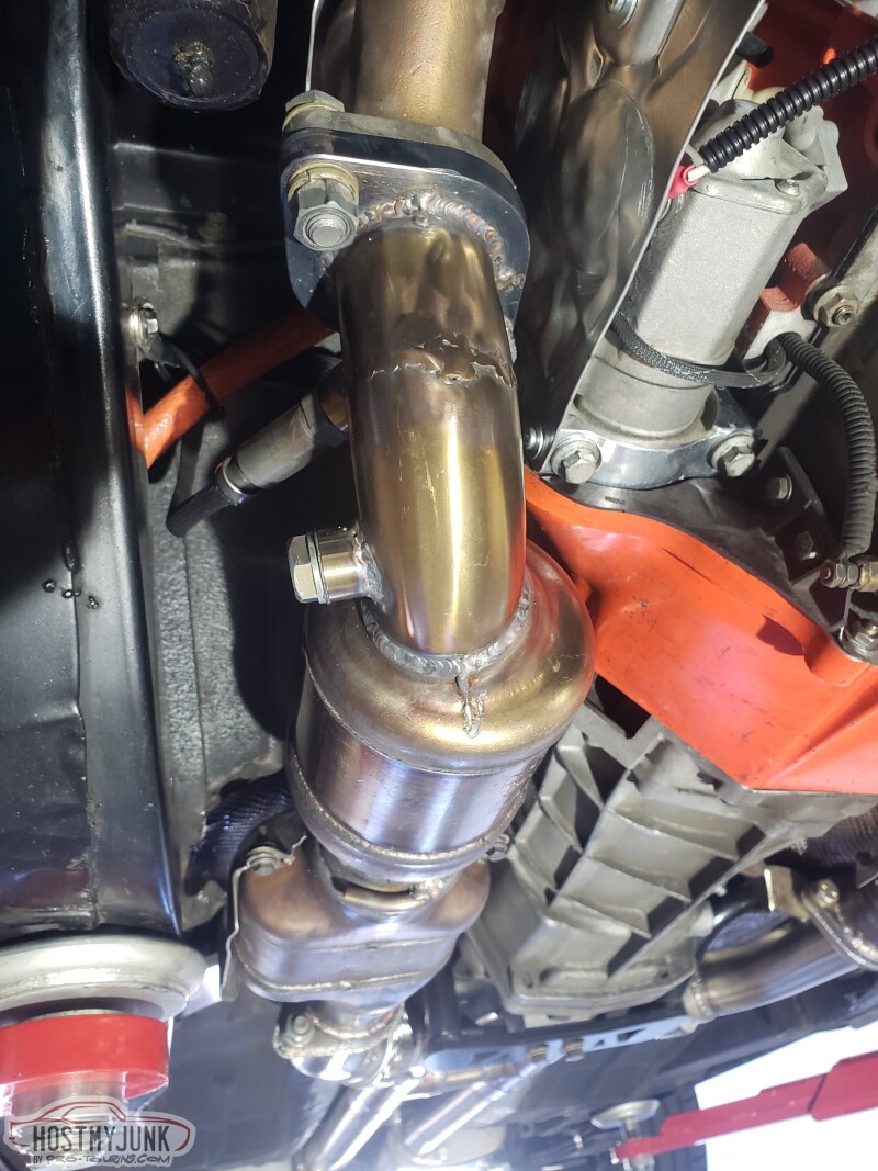

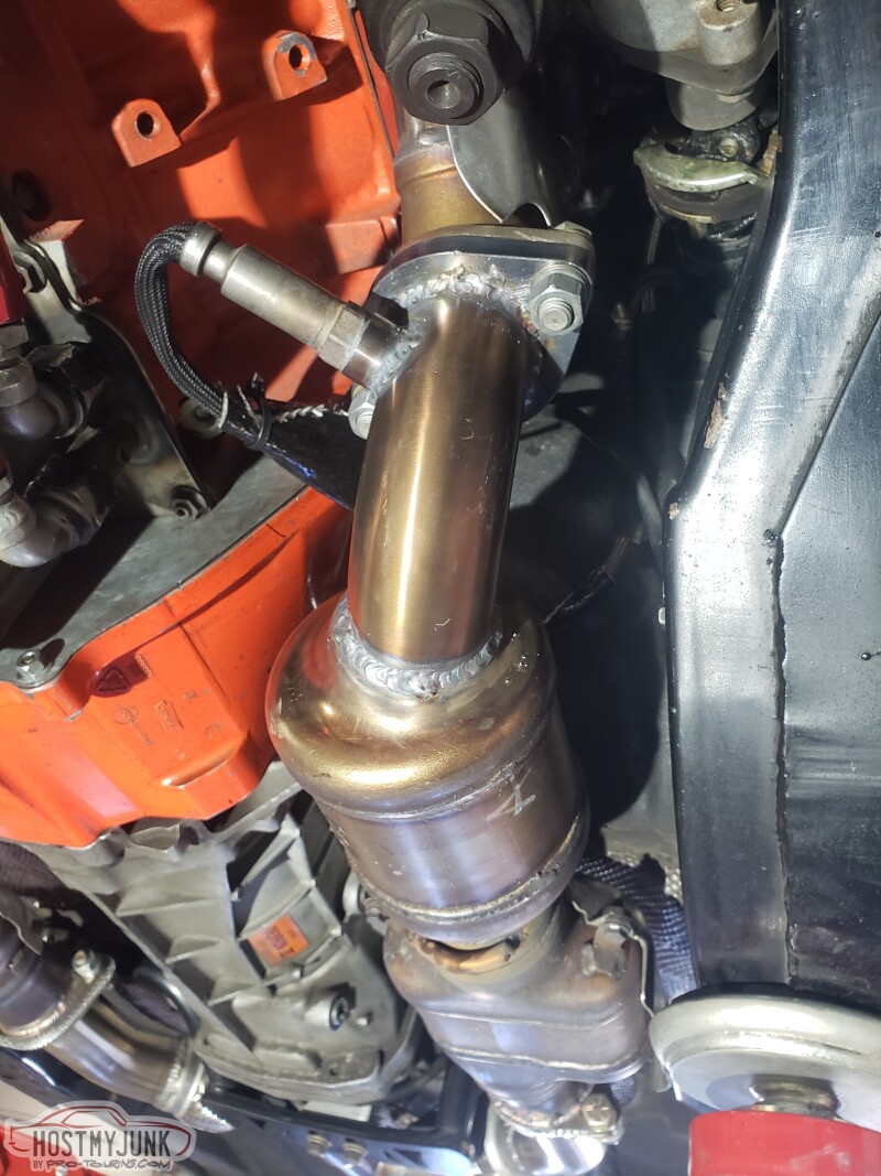

The drivers side did need a bit of persuasion. Several sections near the steering box needed to be slightly adjusted in a hydraulic press. It took about an hour to get sufficient clearance for the tubes, but not all of the heat shields were going to fit. The top portion is fine, but the lower part had to be sectioned into two pieces. The heat shields are so effective that at full temperature I can place the back of my finger 1/4" away with complete comfort.
Since the LT4 that the cats came from have a different flange size and location, hacking began in earnest to make all four line up, clear the floor, bellhousing, crossmember, etc. Since the LT4 has a dedicated primary cat support structure that attaches to the driveline, I tried to mimic that by adding supports from the large tabs on the sides of the T56 Magnum. The idea is to relieve bending stresses caused by unsupported lengths of heavy components (cats). Here’s what the nearly finished system looks like:
LH and RH sides.
To help protect the starter an OEM LS3 starter heat shield was modified and bolted to the aluminum starter mounting plate. The heat shield is made the same way the exhaust shields are, and for the price are less expensive than many aftermarket offerings. The had to have significant "adjustments" to make work but are completely hidden from top viewing.
There’s lots of rubber hangers in the system, along with commonality of flanges. Since I’m not trusting the mufflers to last forever, they have been set up so that they can be easily removed and replaced. When the time comes, each will have a fixture made so that the mufflers and flanges can be built on the bench and easily installed.

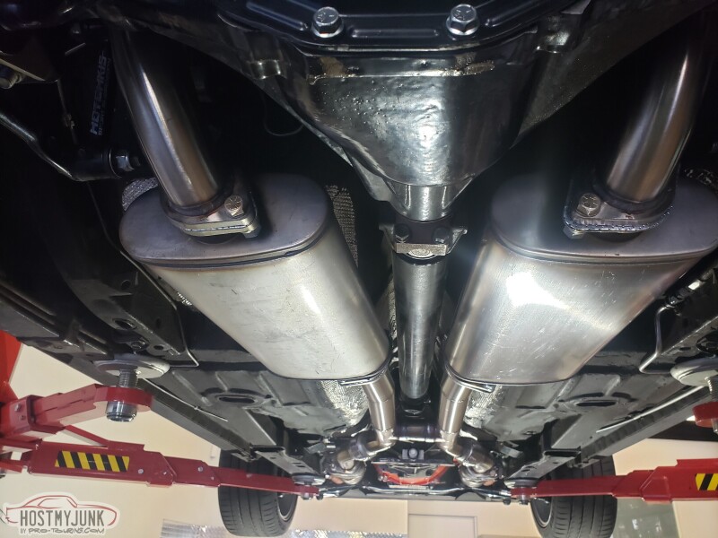

Speaking of mufflers, after much investigation, it was decided to use parts made by AP Exhaust. Though not well known in the aftermarket world we play in, they are huge in the standard replacement world, and look remarkably similar to those used by well-known high-performance aftermarket suppliers. Best of all, $37 each from Rockauto: AP / EASTERN XS125
The common flanges used, except for the manifold/collector flange, were used to make work on the car easier. It meant increasing the size of the holes in the manifold and collector flanges to 1/2". So, lot's of new common length bolts were ordered from McMaster Carr. Skipping ahead a bit, after taking the car out for the first time with the new exhaust, after stopping an letting the car sit for a few minutes, there was a loud PING and the jingling of hardware hitting the ground. Here's the culprit from the manfold/collector flange:

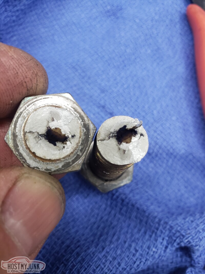

I was hopeful that the inclusion was just an anomaly, but after several more heat cycles another bolt failed, and it too had the same inclusion problem. All the bolts had to be changed to a different type to avoid getting another bad batch. Whenever somebody states you must use Grade 8 bolts for chassis work, I'd much rather choose a G5 from Aircraft Spruce than rely on these from what should be a decent supplier.

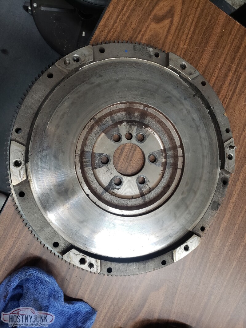

ep, the pilot bearing was destroyed, so the transmission needed to have some repairs done. Anaheim Gear performed the needed shaft repair by making a sleeve for the pilot bearing surface vs. a whole new shaft. New synchros, blocker rings, pads, etc. and she's like new again.
But, why did the pilot bearing fail? When this engine went in the block was a new GM part along with the bellhousing. Should be good, right? I was so wrong.....

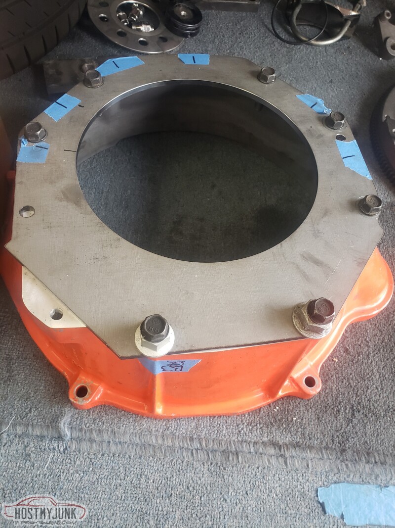

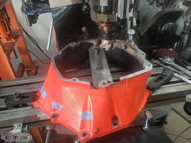

Using the new Bowler T56 alignment plate, measurements were taken to determine the radial and angular/axial misalignment. For radial, 0.005" Total Indicated Runout is considered okay, and 0.002" on the axial for driver cars, 0.001" TIR for high-RPM cars. So the radial is measuring the runout on the bore of the hole, the axial is the measurement on the face of the plate.
Though the radial runout was within tolerance, the axial was 0.011". Yep, that's what took out the bearing, and I'm surprised it lasted as long as it did.
So, how to fix the axial misalignment? The traditional way is to use shims that mount between the engine block and bellhousing. But I can't seen to do things the easy way......
My friend Jeff was nice enough to let me spend the better part of a day using his mill to machine the face of the bellhousing to get it within tolerance. It took five setups to get it right, one heavy pass to get somewhat close, then multiple passes taking just a 0.001" - 0.002" and then checking on the engine. It's under 0.001" now without shims, but it was a PITA to get there. The cross-bar in the setup shown in the photo below was removed as even just a small amount of clamping force caused enough part deflection to create a wavy surface at those locations.
Lesson? Always check the transmission alignment even on new OEM parts.
Clutch:
I'd show a photo of the removed LS7 disk and pressure plate, but instead show just one boring flywheel photo showing the 45k+ mile LS2 flywheel. It's still in good condition, and for how well it works, feels, and the price point, it's a great bargain for many LS builds.

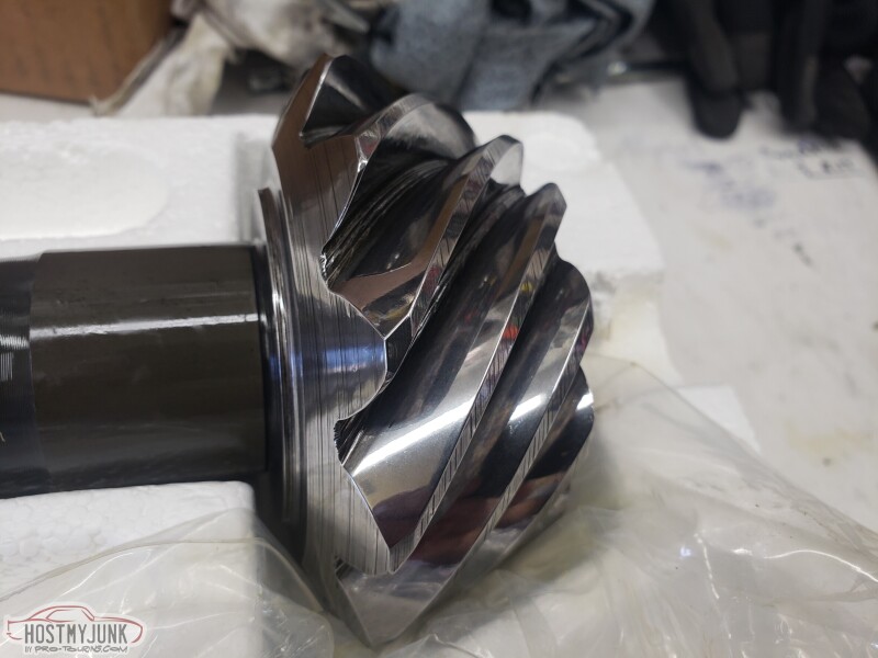

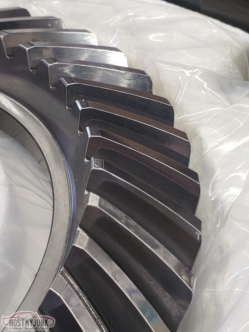

The housing was checked for straightness by Speedway Engineering, and a local shop checked the posi unit and replaced the bearings. The C7 bearing hubs appear to be in good condition and were re-used by bolting them back up to the MillerBuilt housing ends. The MillerBuilt parts have been excellent and have cured all of the pad knockback issues the car had experienced prior. Plus, all four corners run a common C7 hub which makes spares a lot easier to deal with.
Being super fortunate, a new set of mid-1980's vintage 12-bolt 3.42:1 gears were still in possession of a forum member that no longer needs them. With the poor state of gear manufacturing for our older builds, these things are worth their weight in gold. They were sent to GearFX for REM finishing and came out beautiful:

Man…… look at those welds. Lol. I wonder if anyone has ever done a dyno comparison with the x-pipe the way you have it vs. the normal (lengthwise) as I would think the banks might be fighting each other
