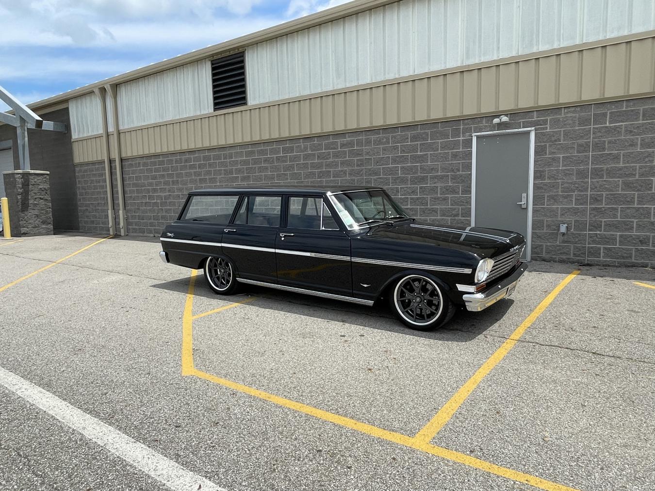

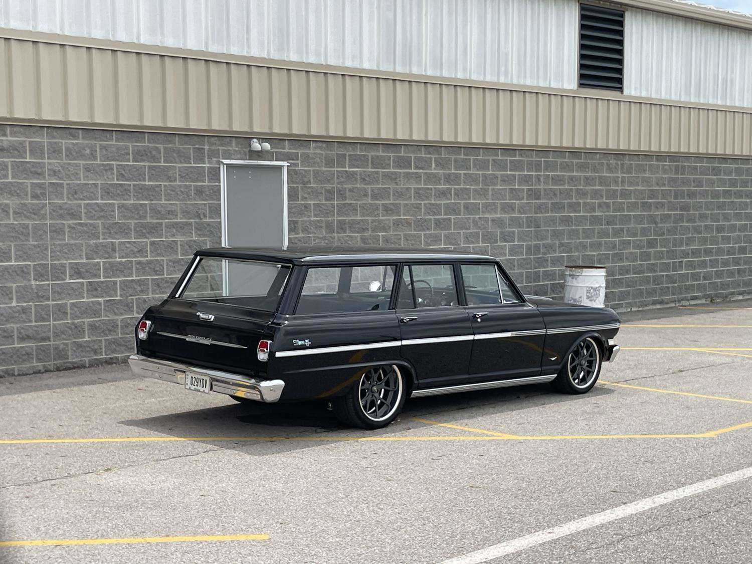

Hello all, me and my dad recently finished our build. This is the second version of the car; first time around it was a bagged cruiser. The objective on the second iteration of the car was drivability with upgrades to suspension, braking, and drivetrain - as well as bringing the car back to being cosmetically all original. We took inspiration from Roadster Shops "survivor series" and are really happy with the results.
Specs:
Church Boys Racing front clip
Church Boys Racing triangulated 4 link rear
DSE mini tub
Stainless Works long tube headers w/ 3 inch stainless exhaust
Wilwood brakes
Billet Specialties 18x9 front 18x10 rear (305 tire)
Built LS1/4L80
Dakota Digital dash
