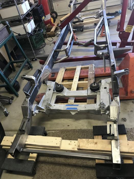

Cut a bunch of rusty metal out so I could get to more rusty metal. Removed the rear diff/axles. Sectioned the frame rails and moved them inward. Fabricated a cross-member and 4-link suspension.

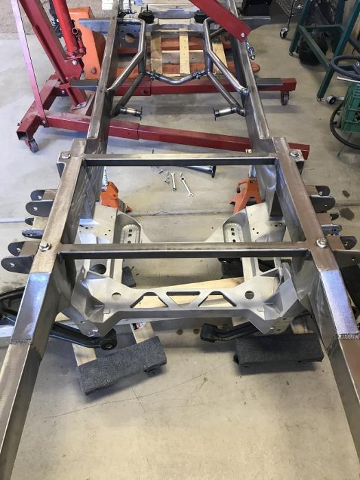

DSE Sub-frame connectors. Fabricated bolt on connection to front sub-frame.

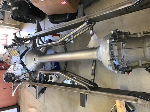

Default DSE minitubs and rear frame tubes
Inner (DSE) and outer wheel houses + trunk extensions so I could get the quarter skins mocked-up to figure out my axle/housing length. Then I bought 80' of 1.75" x 0.120" DOM tube, nice bender and cheap notcher. Started making bars.

Nice work so far. I really like the tubing in the trunk area, it looks good and I've never seen something like it. What was the idea behind adding it?
Thanks. It’s structural. I moved the factory frame rails inward and felt like I needed to reinforce/tie them to the rest of the cage/chassis structure. I’ve essentially adopted the practice of “ladder” bracing the entire factory chassis. Maybe overkill but I guess I’d rather over build it than under build it. You may find the mid-frame upper crossmember interesting as well. Haven’t posted that part of the build yet but I’ll throw one in this post so you can see it. I have a lot of work in the cage for this car.

Got it. Yeah seeing that photo makes it all come together now. Nice work!
