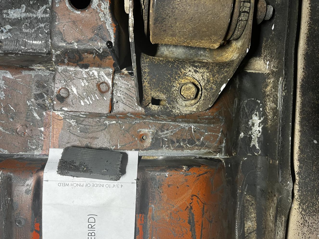

Tried the search function but no answers found. I’m installing DSE subframe connectors and the template gives a measurement of 4.75” to the pinch weld on the rocker at the rear. Mine is 5.0625”. I know that there were wide tolerances for these old cars but I’m trying to be as perfect as possible. Is 9/16” too far out signaling there is something I need to look at before I start cutting? The front measurement spec’d on the template is dead on at 5”. I squared the subframe, it’s an 1/8th out when measured diagonally, which I thought was probably as good as I could expect. Has anyone run across anything that I need to account for or is this just a case of an old car with loose assembly specs? Thanks!

5 3/8” outside of frame rail to pinch weld. I measured the inside of frame rail to pinch weld and it is 7 3/4” as it should be, so I’m a little confused by that. In the first pic you can see the scribe mark representing the inside of the frame rail which is what I based the template placement off. There is some sort of damage to the pinch weld you can see, I measured in front of and behind that area a few inches to rule out that spot skewing the measurement. The last pic shows the template. It’s not parallel to the reinforcement rib, but I’ve triple checked all the layout and the measurements are according to the process in that YouTube video tutorial. I squared the subframe by using the alignment pin holes, and measurement points were the forward control arm mounting point and the flanged hole next to the spring pocket on rear. I measured it three times to make sure I got the same result each time but that template being off makes me second guess it.

Spoke to DSE this morning and they said not to worry about the connector to pinch weld measurement if the subframe was square. I asked why there was a difference in the measurements on the template front to back and he wasn’t sure. Transferred to someone else but 45 minutes of hold time later I moved on with my day. I’m going to remeasure the sub, make sure the connector is parallel the best I can and go for it.
