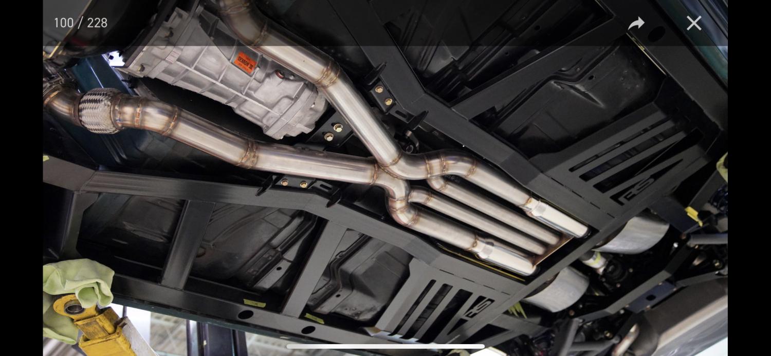

Anyone have any experience with a Helmholtz Chamber?
One of the things I’m super annoyed by is exhaust drone or resonance. I want to be able to have a conversation without yelling when driving & not into loud exhaust in my cars.
I noticed Roadster Shop has been doing these for sometime on their builds, Magnaflow now offers this muffler as a kit.
