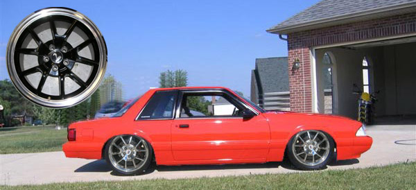

Personally I think the black centerred FR500 style wheels would look great on your car. I couldn't find a pic of the black ones that would let you see them well when I shrunk them down to fit the car, so I used the chrome ones, but you get the gist . Just a thought. Otherwise I would go with the black Bullitts.

I really like the style of the FR500 too, but a 9" wide wheel on the front of a Fox body is almost too much. I know people do it all the time, but on an '89 it will limit my turning radius. Earlier Foxes had a jacking pad on the lower control arm. I'm liking the colored centered wheels too. The car has the center of the hood painted black as well as all of the moldings and trim around the windows. I'm starting to lean toward Black Bullitts in 18X9 and 17X8 (I like a little stagger front to rear)
I'll have to look into the FR500's some more though. Man at this rate, I'll never make up my mind.
Thanks for the input!
Also, I've kept the rear axle width stock fox length. The wheels I have on it now are better suited for SN95 width (.75" longer axles on each side). When you look from the rear of the car it really exaggerates the rear track being narrower than the front track, not a desireable look in my mind, but some people don't even notice. I did this so I could run a 9" wide wheel with some lip on the outside instead of having to run a wheel with an extreme offset.
