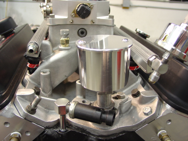

You can always build one. This one was made using a distributor base and a Hall Effect sensor from a 96 sbc crank sensor. It is small compact and very dependable.

If you do some searches on the the MSD trigger you'll see its output is 5v and does not have the same shape as a typical hall effect sensor.
FAST and Accel ECUs can't read the signal, the BS3 might be able to, but I'd ask their tech support.
